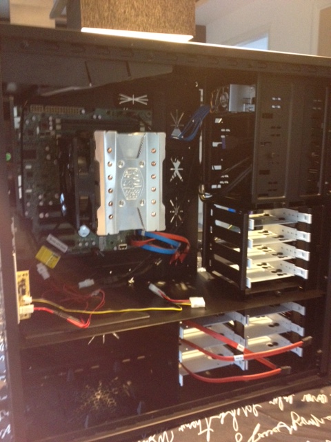

First hurdle found... and solved..

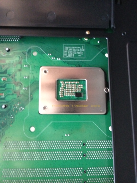

The Define XL case has a nice feature in that there is a door on right hand side (within the case), giving you room to screw in the backplate for your cooler.
Unfortunately in combination with my motherboard this does not work, two of the screw holes of the motherboard are positioned slightly outside of this "door", this means the whole contraption does not work and you need to attach the cooler with motherboard unscrewed and then screw it in. Possible also but a drag ofcourse..
And this is the case with everything screwed in !
Now it is time to Frankenstein my old server, remove ups and drives and put them in this system. I'm not going to do that tonight though, i'll save it for the weekend.
Sofar however the case is not a dissapointment (with the exception of the above), there is a lot of easy room to store cables and enough room to manouvre around.

And I'm done ! I'll post a pic tomorrow.
Few more hurdles:
1) The CoolerMaster Silent Pro Gold 800 powersupply (PSU) missed the 8 pin cpu connector, I have used only one 4-pin but have ordered a converter also;
2) The motherboard cabling of the PSU is to short to be routed behind the backplane, the 4 to 8 pin converter will fix that for the cpu connector, I have ordered an extension for the 24-pin.
3) Appears I have not received the screws needed for the 4in1 2,5" drive bay, have mailed Azerty for replacement.
