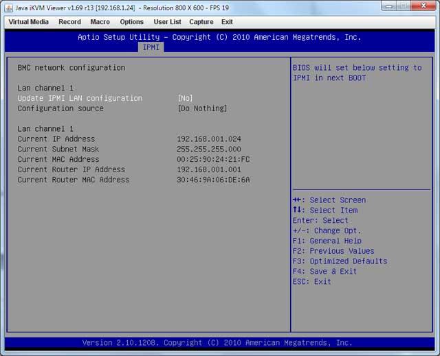

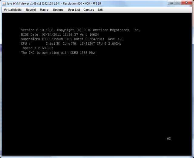

Were do you find the IPMI version? My BIOS looks to be 1.0.
Also, if i look at the IPMI tab, it looks like its configured for lan1.
And there is no option to change that.

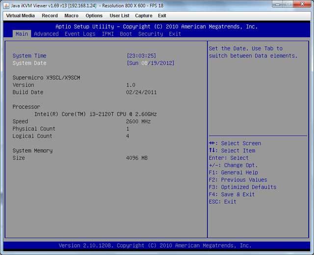

Another bios screen

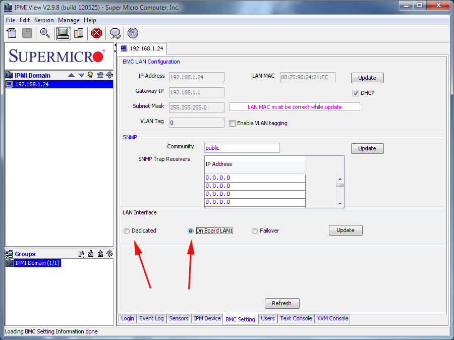

Ok, enough with the screenshots :) i think i found it. You can change the IPMI port using the IPMIView software:
You were ahead of me, just wanted to point you to the BMC LAN settings in IPMIview.
You had a rather old IPMI firmware, maybe that was the problem. Well now you know where you can change it.
I've changed the IPMI from lan1 to 'dedicated' and it works :) Also, i've updated the BIOS from 1.0 to 2.0a, and updated the IPMI firmware from 01.01 to 01.63. Everything looks ok (so nothing has actually changed) ;)
