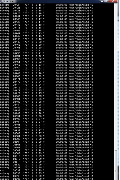

The web interface is unresponsive even with no attempts to access the server.
Here is another print screen of the requested command. It repeats itself a few times each minute from about 9am until now, the attached pic is only a segment of that.
This may be an issue. Why are there so many smbd processes? What add-ons are running?
I haven't installed any ad ons to the server.
The screen shot shows apparently hundreds of smbd processes.  Typically, there are only a few.
That is your issue.... (Of course, I do not know the solution, but at least you now have a symptom that is very unique)

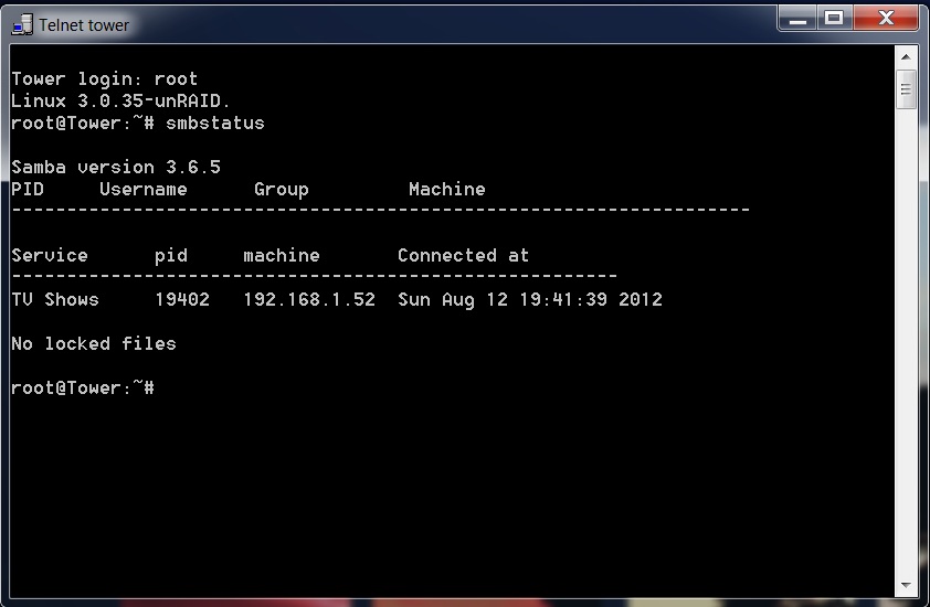

What does
smbstatus
show?
This seems to be similar to your issue
http://samba.2283325.n4.nabble.com/Re-hundreds-of-smb-D-processes-td2435734.html
That doesn't sound good. Would a command like that work for unraid as well?
I have attached a print screen of the command.
Whats odd is it seems to happen whenever I run a parity check and not at any other time.
My server is used to stream media only. A sonos music library, TV shows and Movies streamed to 2 Dune media players with yaDIS jukebox. Thats about it! The music libraru updates once a night and yadis only updates the movie jukebox when I tell it do, every couple of days usually.
If you've not added any addons, and not created a smb-extra.conf file on your config directory you can give their possible solution easily.    Apparently something on your LAN is creating SAMBA connections, but not closing them.  Eventually, it probably ends up with all the resources involved on your server being allocated, thus things stop working.
