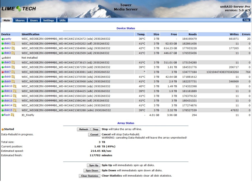

Last night before I went to bed I started a parity check on my server (RC5). This morning I have found what I believe is a drive failure. Ive read a bit about the red dot meaning the drive failed in a write request but I just wanted to make sure by asking on here.
It currenty states there is a parity rebuild in progress. Once that has finished can I swap the drive out without losing data? How do I find out where unraid has placed the data that was on the failed disk?

No, according to the screen shot, it says a DATA REBUILD is in progress.  It is re-constructing the failed disk.  It is not a parity check.
Let it finish.
Post a syslog.  (zip it for attachment)
Check out the speed and estimated finish and the number of writes. I don't think Dan201 will have the patience to wait almost 82 days.
I missed that...  :-[
I did see it was almost half way done.  (the number of "writes" did not bother me)
Clearly something is unusual.  he needs to examine the syslog to see what is happening.

The number of writes is not abnormal from what I've seen.  When I purposely pulled a drive, my writes went from ~100k to some ridiculously high false number.  A bug I assume.
Its still at 49% at a speed of 28.26Kb/sec.
I definitely only started a parity check last night, when I woke up it was rebuilding the parity instead.
Should I be worried?
