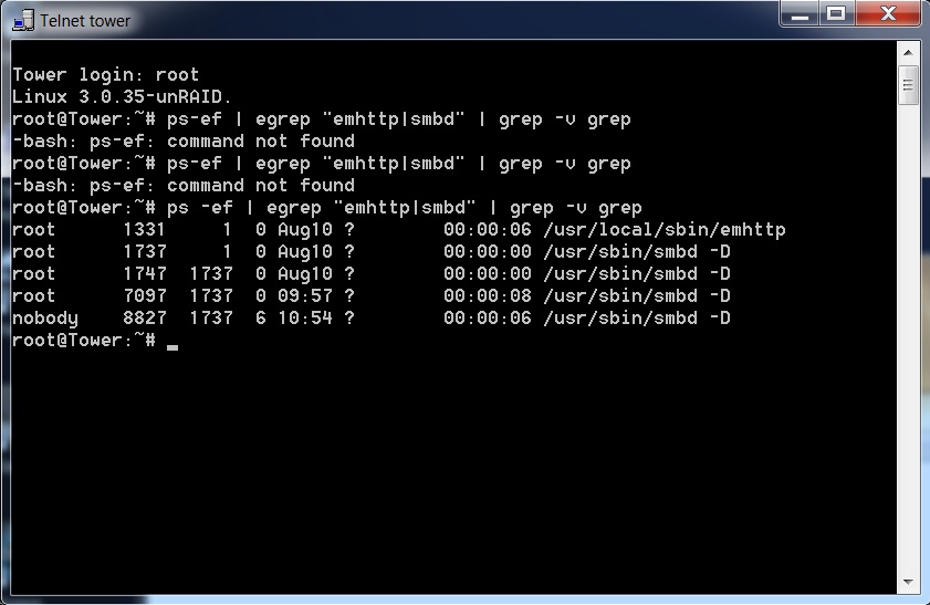

Oddly the pipe symbol comes up when I use the key next to z even though the image printed on the key is a broken line. Anyway I type it in but the reply I got from the server was ps-ef: command not found.
A space should be added after ps:
ps -ef | egrep "emhttp|smbd" | grep -v grep
Maybe nice to know what the command does:
ps -ef    -> give a list of all running processes (like taskmanager in windows but then just in a list)
|          -> instead of giving the output of the previous command (ps -ef) to the screen send it to the next command:
egrep      -> take the input (in this case the output of ps -ef) and filter it, show me eveery line with the words emhttp or smbd"
The last grep command actually filters out one predictable result (namely the process that is performing these commands).
Unix is fun :-)
Thank you for explaining.

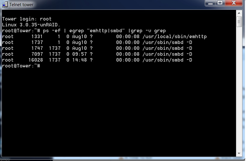

Here is the resulting information. Should I let the server become unresponsive by running a parity check and then entering the command again?
Joe was trying to find out if the webinterface becomes unresponsive because the processes are not running any more.
The output of the command shows that the processes are indeed running, I am guessing that the unraid webinterface now also is available right ?
Next time it becomes unresponsive do the check again and post results (screenprint will be fine).  That will be the next step in diagnosis (we do need "the power of Joe" in this, I do not know where he was heading).
Correct.  Typically SAMBA (the smbd processes) and emhttp (the web-interface) are some of the first to be killed off by the kernel by its out-of-memory process in an attempt to free memory,as they have been idle the longest.
My guess too.  Still, very strange, as telnet seemed to work according to a prior post, so not likely to be a network issue.
You figured out what I was looking for.  There are very few things that stop both the web-interface AND samba... but not telnet.

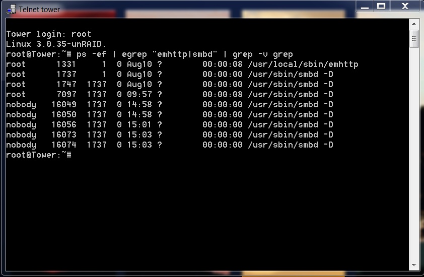

The web browser has become unresponsive but I can still access the disks via my network browser from my PC.  Attached is the pic of the command results.
