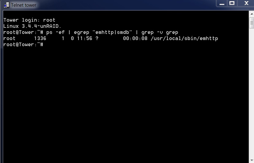

The web interface is unresponsive even with no attempts to access the server.
Here is another print screen of the requested command. It repeats itself a few times each minute from about 9am until now, the attached pic is only a segment of that.
This may be an issue. Why are there so many smbd processes? What add-ons are running?
Are hundreds of smbd processes still running?

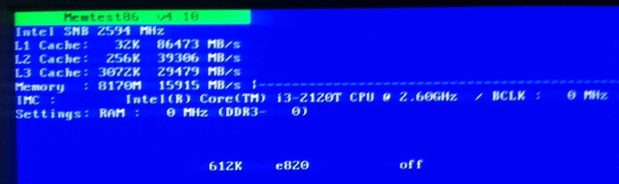

Hi gents
I launched memtest but im not sure its actually doing anything. Ive attached a photo of the screen after its launched, do I need to do something in order to start the test?
The screen didn't change at all and with no options to cancel or reboot I had to manually power it down. Ill wait for some more instructions on that test as theres doesn't seem to be any info on the wiki.
It looks like memtest detected 8GB of RAM, don't know why it failed to start the test. Maybe try pulling one of the RAM sticks out and retry?
Oh, it failed to run? An on screen message might have helped. Ill try again a bit later but if it failed that can't be a good sign for the memory. I have 2 4gb ECC sticks in there.
If it wouldn't respond to key strokes, it was probably locked up. The upper right quadrant normally shows the test progression, and it is supposed to start the test automatically.
I tried to start it 3 more times but each time I got the same result. I then looked at the memtest file in the latest RC6 download and noticed it was larger than the one on my flash drive so I copied that over as I assumed it was a newer version. WHen I ran it again it was still saying 4.10 so I guess its not updated.
2 more attempts failed to run.
Would bad RAM stop the test from running or is it something else?
