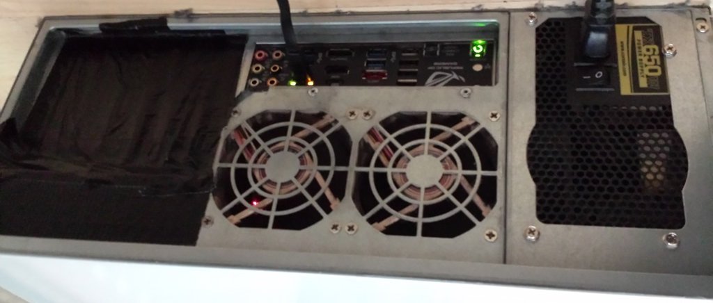

June 7, 201313 yr I replaced the Coolinks with Noctua NF-P12. The temp after two hours of a parity check is 49c. Not bad! The R8s are blowing warm, finally. I noticed that at the back of the case there are holes/gaps for the expansion cards. Do I need to block these off too as I think the R8s will suck air from those holes/gaps?
June 8, 201313 yr 49C is still a bit warm, and I would not like to leave it there for long. The big thing is not only enough air-flow, as you have already come to think about, but PROPER air flow direction! I would check with a small piece of paper, and or feather... what the air flow is actually doing. The places you NEED the air to go in is of course at the front, over the drives. Air going IN the case at any other point will reduce the important drive cooling air flow. My other concern is that if you just block the rear vents, you might reduce power supply air flow. Sadly the other NEEDED air intake is on the power supply. One issue I have with the small (for what it does) case with limited air-flow options of the Norco series cases, is the internal airflow gets complicated by adding a "standard" power supply which also has air flow from the outside, over the power supply components and into the computer case... This increases air intake can, and often does reduce the needed cooling over the drives. The total air from all other locations on the case are the only exhaust options possible. So ALL other places need to be EXHAUSTING air from the case. If not, the drives, and possibly the power supply are being starved of needed cooling. One thing that CAN help also, is to REVERSE the fan on the power supply... This may or may not be good to do, and should only be done after fully understanding what your air-flow is currently doing. The goal here, if this path is chosen, is to remove the power supply as a source of starving drive cooling air flow. The ambient temperature will NEED to remain lower, than would otherwise be allowed in this situation to prevent power supply over heating. But I am much more concerned with the temperature your drives are already running at. If you choose to reverse the power supply air flow, it will also pull air OUT of the case and exhaust out the back, as your rear case fans already do. You will then also need to test blocking the other spots in your case that do not actively blow air out, to further assess if you need to block or not for overall best case cooling. (but I would think with the extra exhaust from the reverses power supply fan, that it may work out well to leave the other spots open.) You may also want to look at temperature changes from ambient, rather than just the drive temperatures. If you room and server area temperatures are increasing also during parity checks, this may be a bigger issue than the actual air-flow of the case! Also, you may want to look also at the internal case temperatures, CPU temperatures, and power supply temperatures... Some of these possibly just by feel, like touching the case top, bottom, power supply back, etc. Just to get an idea if things are over-all warm, cool, hot... not just what the drives are doing. Sorry no definitive answer here, it does sound like things are getting better though. I am just not comfortable running even in the 40 C range for extended periods of time, let alone 50 C or close...
June 8, 201313 yr Well I taped off the rear of the case and the temps dropped from 49 to 46. Not bad! And the PSU feels cooler when doing a parity check. The rear fans are so close to rear opening that they must have been sucking air through those. It is well known that Hitachi HDDs run hotter especially the 7200 rpm ones. 5400 rpm ones now run even cooler now in my case.
