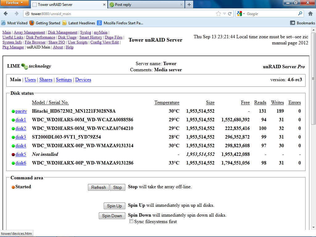

Still no luck getting my server to show up.  I am totally lost as to what to do next.
If I create a new flash will all my data be lost?  I have 5 drives, 4 data and 1 parity.  Will the drives be recognized if I create a new server and add the drives?
I added a few print screens in hope that maybe some one can see a problem.
Thanks in advance,
Oscar
Another print Screen
one more

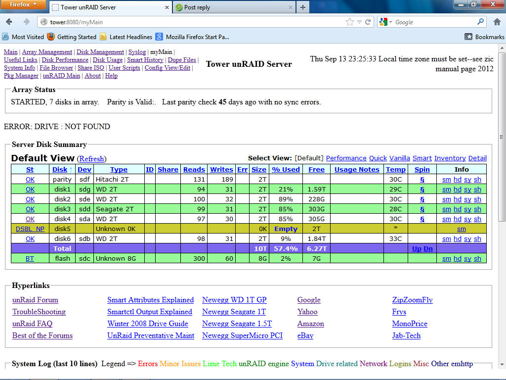

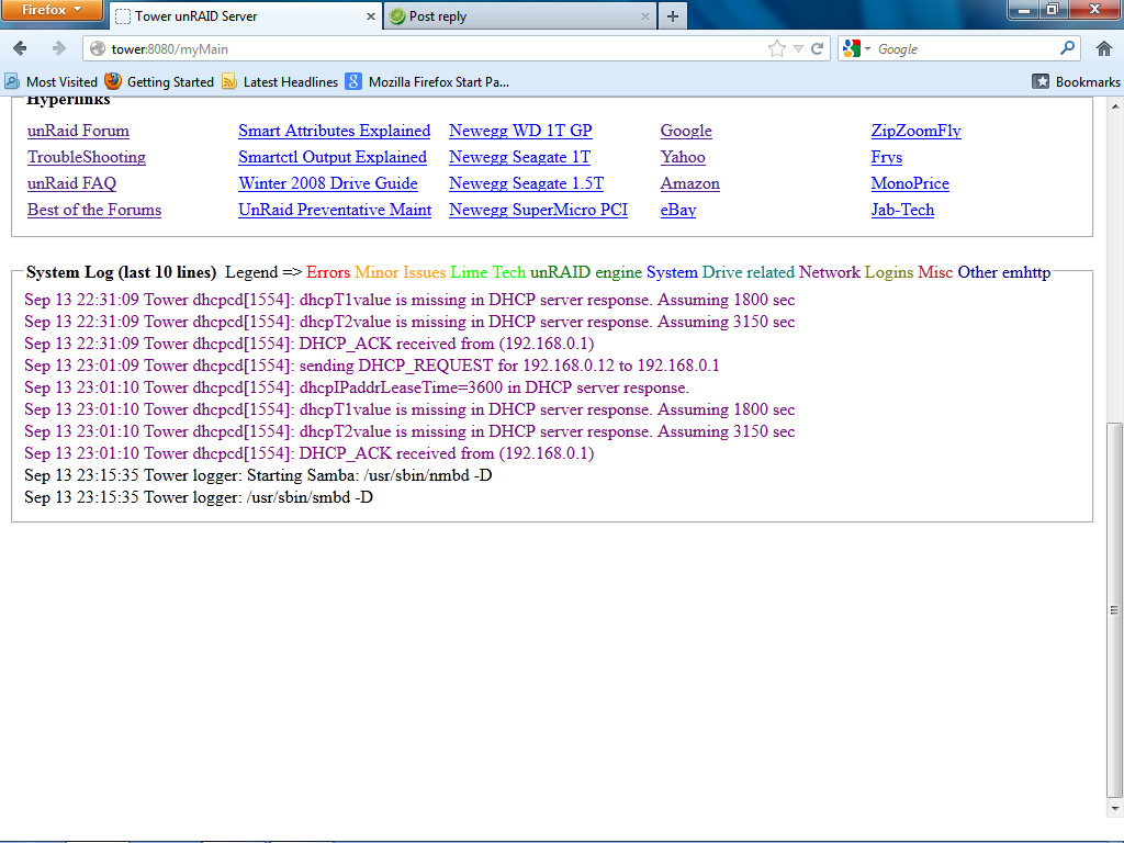

The issue appears to be your Windows 7 PC. I would get hold of a laptop, give it a static IP or 192.168.0.200 and set it to "WORKGROUP". Then plug it into your cable modem and see if you can ping the NAS.
Also I see your NAS is not static, it's IP is now 12. Log into your router interface and make it static....
