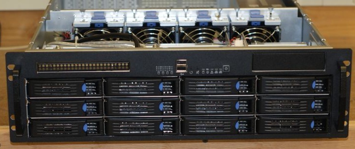

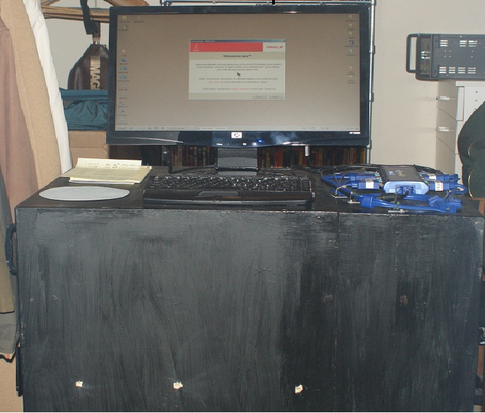

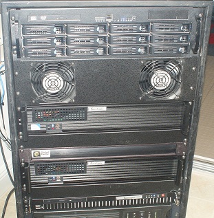

I thought the price of server racks were two high so I built my own out of plywood. I do a little cabinetry when I get the urge. I made it 30" deep, no back, and rails mounted front and back.  The rack holds a 1.5 KVA UPS; a power distribution panel; twin 4" fans on a rack panel to keep air moving in the rack (probably not needed since the back is open; 3 PC's (each 2U high, one web server running Apache, one Home Automation running Homeseer, one spare); and the unRaid system. The unRaid system is in a Chenbro 3012 case which is 3Ux26" with 12 Hot Swap drive bays, internal space for 2 Drives (I Sata, 1 IDE), 1 slim CD ROM, and a PSU which is 2 redundant units @ 500 Watts per unit. The case is industrial quality and probably overkill, but I really like it. It even has hot swap-able internal fans. The server rack is about 48" high and sitting on top is a small monitor, keyboard/glide-Pad, and a 4 port KVM switch. the server rack is on casters with a nice umbilical cord to bring all the wiring to a wall panel which has all sorts of "Glue" components for Home Automation.

Here is the front view Upper portion of the server rack. The upper picture shows the following from the top down:
unRaid Server @ 3U
Fan unit @ 4U
Web Server PC @ 2U
Blank Panel @ 1U
Global Cache GC-100-18 @ 1U
Home Automation Server @ 2U
Blank Panel @ 2U
Spare Server @ 1U
UPA 1.5KVA (partial view) @2U
The picture of the lower portion shows the following from top to bottom:
Blank Panel (Partial View) @ 1U
Spare Server @ 1U
UPS 1.5 KVA @2U
Audio Amp @2U
Power distribution Panel (110 volt) @ 1U
Vent Panel @ 2U

Huge is a relative term.  Overall it is about 20" wide, 30"deep, and 48" high.  As many racks are 96" tall, this is more like Huge/2. It needs to be 30" deep to accommodate deep server cases. The unraid case is 26" deep. The width, 20", is controlled by the fact that most racks are built to accommodate standard rack mount components which are built to go in "19 inch" racks. The closet it is in is roughly 7x8 with a 10 foot ceiling 560 cu ft.
It fits my needs and If I need something else I can always build another with a 1 or 2 sheets of plywood.
