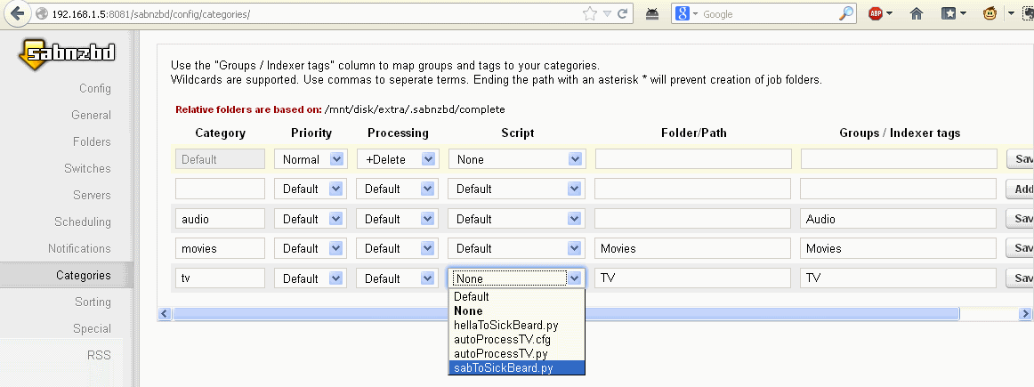

First SAB set up:
http://i324.photobucket.com/albums/k331/bdshepard/SAB1_zps63e7fb5e.png
http://i324.photobucket.com/albums/k331/bdshepard/SAB2_zps9ea60698.png
http://i324.photobucket.com/albums/k331/bdshepard/SAB3_zps3f9e5e6d.png
http://i324.photobucket.com/albums/k331/bdshepard/SAB4_zpsf3ff1d62.png
http://i324.photobucket.com/albums/k331/bdshepard/SAB5_zps01735aad.png
This last one shows (from Windows) the location of my autoProcessTV.cfg file, just to be sure it's in the right place

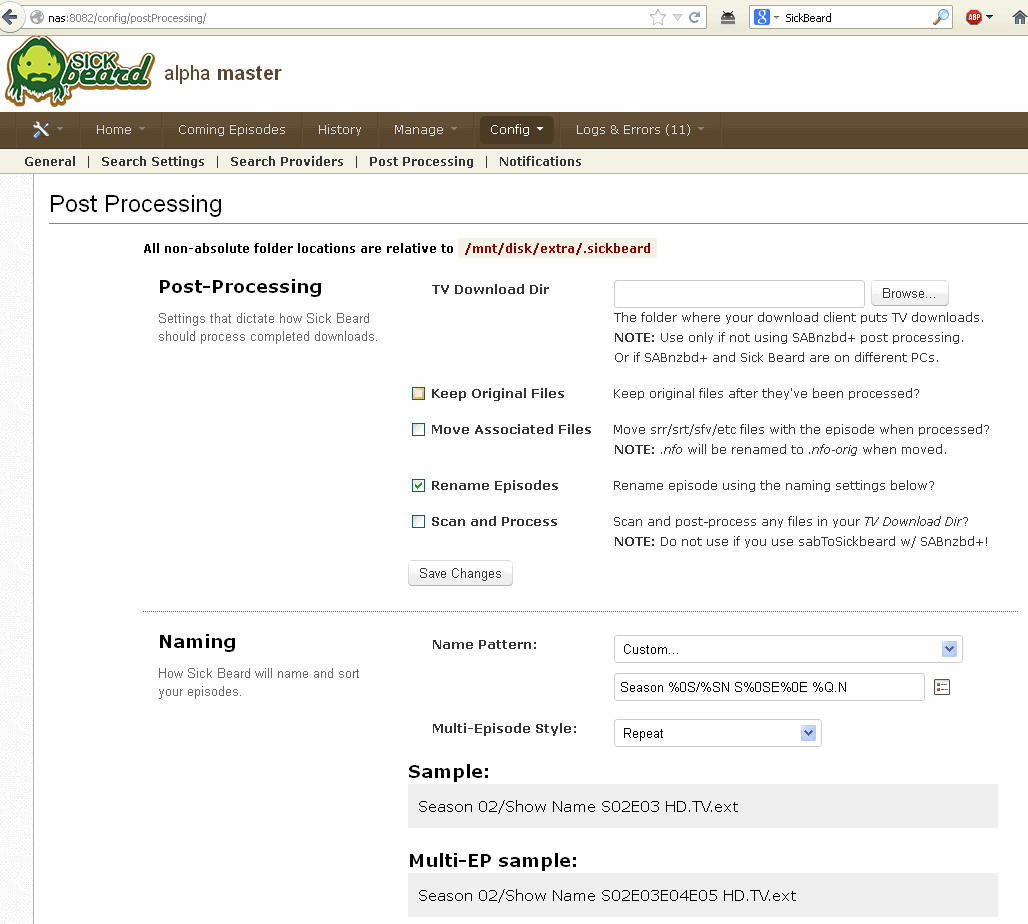

Now SB setup:
http://i324.photobucket.com/albums/k331/bdshepard/SB1_zps51ecd593.png
http://i324.photobucket.com/albums/k331/bdshepard/SB2_zps3ba2273b.png
http://i324.photobucket.com/albums/k331/bdshepard/SB3_zpsfdbc3c9a.png
If there are other screens you need to see, please let me know, I'm more than happy to provide additional screen shots.

Do you find the scripts? IE, on the categories  page the sabtosick script is in the dropdown? If yes, then the directory location is OK.
Yes, it can find the script (image 1)

Do the downloads appear in sab under the TV category?
Yes they do. (Image 2) - the top row is a test I just did with changed config, then 2nd is a show that downloaded earlier with SAB doing the sorting (as posted in my most recent images)

I went to the SB forums and did a search on the error message. The suggestion there was to replace "localhost" in the autoProcessTV.cfg file with the actual IP address of the hosting machine. I did so, and it worked!  Almost...
On the first episode that I downloaded after putting in the actual IP address, the test worked, it processed completely, and moved the downloaded TV show to the correct directory, except... I had the naming pattern set to:
%SN/Season %0S/%SN S%0SE%0E %Q.N
So, for that one, I had my fresh episode in:
/mnt/user/TV/How It's Made/How It's Made/Season 18/...
In the attached screen shot, I changed the SB naming pattern to:
For the next episode that was downloading, my episode ended up in:
/mnt/disk/extra/.sabnzbd/complete/TV/How.Its.Made.S18E13.720p.HDTV.x264-KNiFESHARP/episode
So, with the change in the config file, I'm no longer getting the 'connection refused' error, but with the change in the SB naming pattern, the files are still being left in the same place as they were when I was getting the error...

So, back to back, one worked, but reported an error, the other failed to work, reported no error, but based on the length of the log file, doesn't really have seemed to have tried.
While I was reviewing the post for typos (still no guarantees!), a 3rd episode of season 18 (episode 7) finished downloading. It was properly moved, yet reported an error, like episode 9 did. I've got a few more to go, I wonder if it only works properly for odd numbered episodes...
Any additional thoughts?
EDIT: I finally got one that it flagged as successful!
Loading config from /mnt/disk/extra/.sabnzbd/scripts/autoProcessTV.cfg
Opening URL: http://192.168.1.5:8082/home/postprocess/processEpisode?nzbName=How.Its.Made.S18E03.720p.HDTV.x264-KNiFESHARP.nzb&quiet=1&dir=%2Fmnt%2Fdisk%2Fextra%2F.sabnzbd%2Fcomplete%2FTV%2FHow.Its.Made.S18E03.720p.HDTV.x264-KNiFESHARP
Processing folder /mnt/disk/extra/.sabnzbd/complete/TV/How.Its.Made.S18E03.720p.HDTV.x264-KNiFESHARP
Processing /mnt/disk/extra/.sabnzbd/complete/TV/How.Its.Made.S18E03.720p.HDTV.x264-KNiFESHARP/how.its.made.s18e03.720p.hdtv.x264-knifesharp.mkv (How.Its.Made.S18E03.720p.HDTV.x264-KNiFESHARP.nzb)
Found result in history: (79485, 18, [])
Parsed How.Its.Made.S18E03.720p.HDTV.x264-KNiFESHARP.nzb into How Its Made - S18E3 - 720p.HDTV.x264 (KNiFESHARP) [ABD: False]
Checking scene exceptions for a match on How Its Made
Looking up How Its Made in the DB
Looking up name How Its Made on TVDB
Lookup successful, using tvdb id 79485
Loading show object for tvdb_id 79485
Retrieving episode object for 18x3
The old status had a quality in it, using that: HD TV
SB snatched this episode so I'm marking it as priority
Is ep a priority download: True
There is no existing file so there's no worries about replacing it
This download is marked a priority download so I'm going to replace an existing file if I find one
Found release name How.Its.Made.S18E03.720p.HDTV.x264-KNiFESHARP
Destination folder for this episode: /mnt/user/TV/How It's Made/Season 18
Moving file from /mnt/disk/extra/.sabnzbd/complete/TV/How.Its.Made.S18E03.720p.HDTV.x264-KNiFESHARP/how.its.made.s18e03.720p.hdtv.x264-knifesharp.mkv to /mnt/user/TV/How It's Made/Season 18/How It's Made S18E03.mkv
Deleting folder /mnt/disk/extra/.sabnzbd/complete/TV/How.Its.Made.S18E03.720p.HDTV.x264-KNiFESHARP
Processing succeeded for /mnt/disk/extra/.sabnzbd/complete/TV/How.Its.Made.S18E03.720p.HDTV.x264-KNiFESHARP/how.its.made.s18e03.720p.hdtv.x264-knifesharp.mkv
This one did, in fact, actually get moved to the proper directory, too.
It's really odd. I'm thinking it's either a permissions thing of some sort or it's your naming convention. I have mine start with the episode number and I've never seen that happen.
Well, I've just changed the naming to Season %0S/S%0SE%0E %SN (Season 02/S02E03 Show Name.ext), we'll see if that makes any difference.
You mention permissions, anything in particular I should be looking at there?
