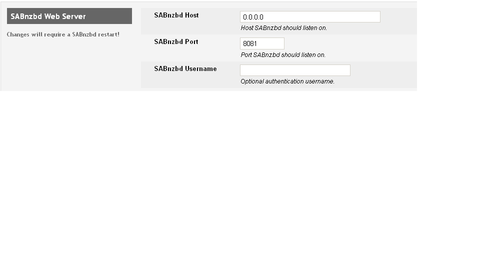

I've put the 0.0.0.0 in both the SAB setup as per my previous post, and with your tip it's in the autoProcessTV.cfg, and still, I get this error:

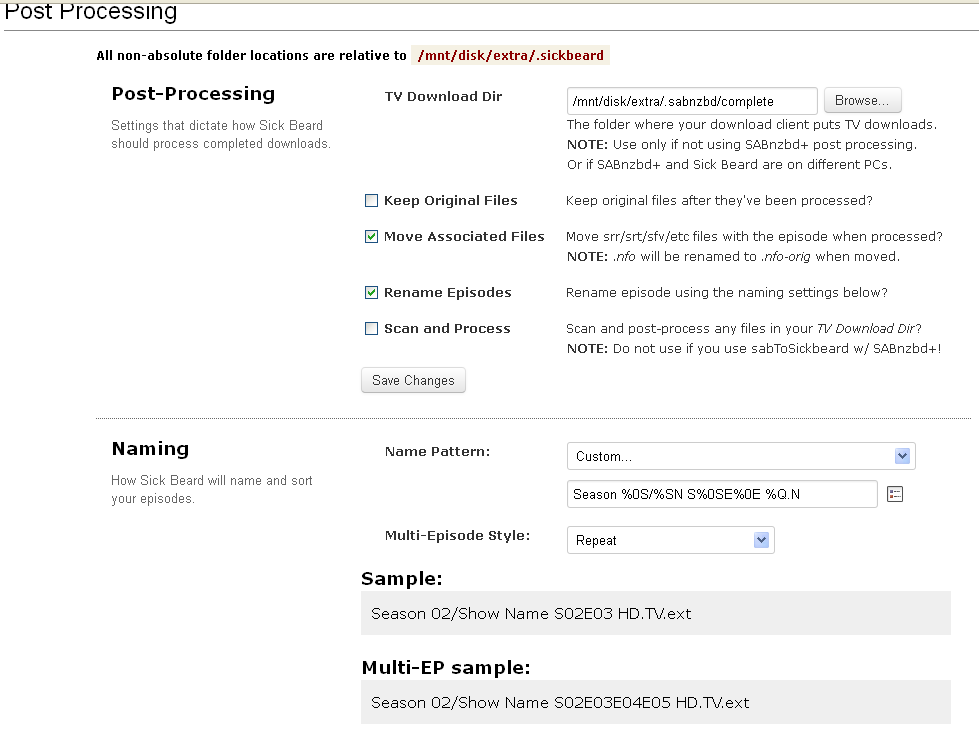

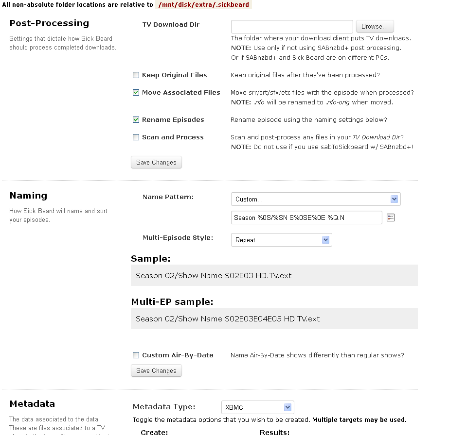

I'm attaching screen shots of my SAB & SB post processing setups. As you can see, I'm not using SAB for post processing (pretty snazzy arrows for MS Paint, don't you think? ;)), and I am using SB. My guess is that something is not set properly in SB, but I don't know what - it all looks reasonable to me. I'm also including my autoProcessTV.cfg file, even though it's pretty basic, just in case you see anything wrong in there.

Your sabtosick script isnt' working so the only thing I can conclude is that you have set sab to download the completed TV files into /mnt/user/TV. If yes, don't do that. Use a temporary download directory (standard is the Downloads directory inside the sab application directory) and the files will be moved from there to the final location.
You have the catagory in sb set to something like "tv" and a "tv" catagory in sab setup which says save the files to a tv directory and to use the sabtosick script? When you download a tv show the nzb downloading line in sab should show the catagory as tv and the post processing as sabtosick. You can use tv or television or tele or whatever you want to call it for the catagory but both sb and sab have to be the same or it won't work.
Also, I'm pretty sure you want to delete the directory location at the top of the sb post processing screen. I can double check tonight.

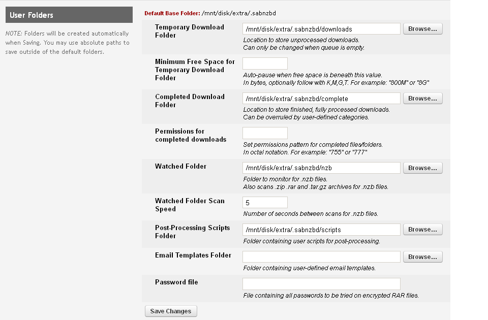

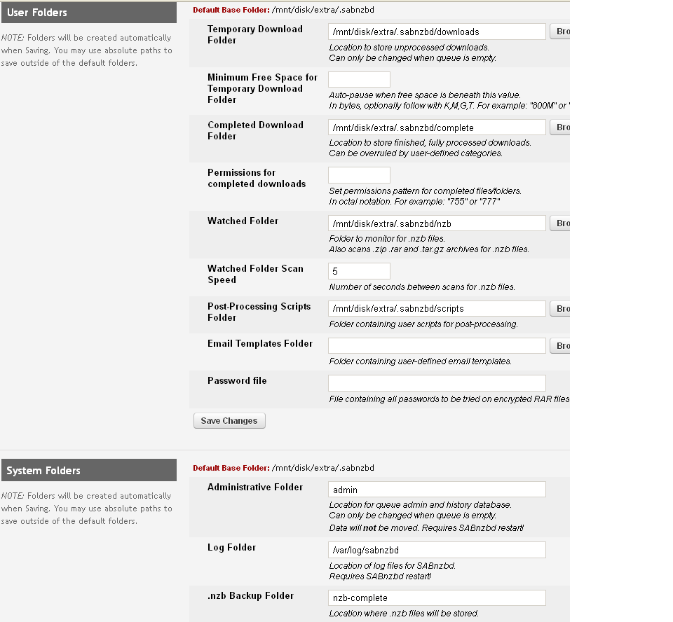

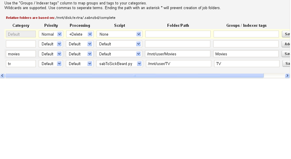

Here are shots of the relevant SAB setups. I believe I've got them correct. /mnt/disk/extra is an old 320GB PATA drive I had laying around, so I figured this would be a good use for it - especially since SATA ports are at a premium in my ultra-cheap-leftovers build.  :)
You have failed at entering paths.
You've got sb pointed to /mnt/disk/extra/.sabnzbd/complete and sab putting the completed downloads into  /mnt/user/TV
Make the directory for the sab tv category simply TV, nothing more.

I had the full path in SB because I though I wasn't using SAB for any post processing. My understanding was that SAB would get the file, then tell SB to do its thing. I guess the SABtoSick script is considered SAB's post-processing. I hadn't looked at it from that angle.
Thanks for your help. I believe that I've now got it configured correctly, and I'll find out tomorrow evening when my next show is on. (One of the drawbacks, I suppose of not watching a lot of current TV - long waits between new shows...)
sab runs the script  so it's doing the processing. You can hit the download on an existing show to test.

SAB config screen shot is attached.

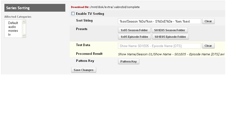

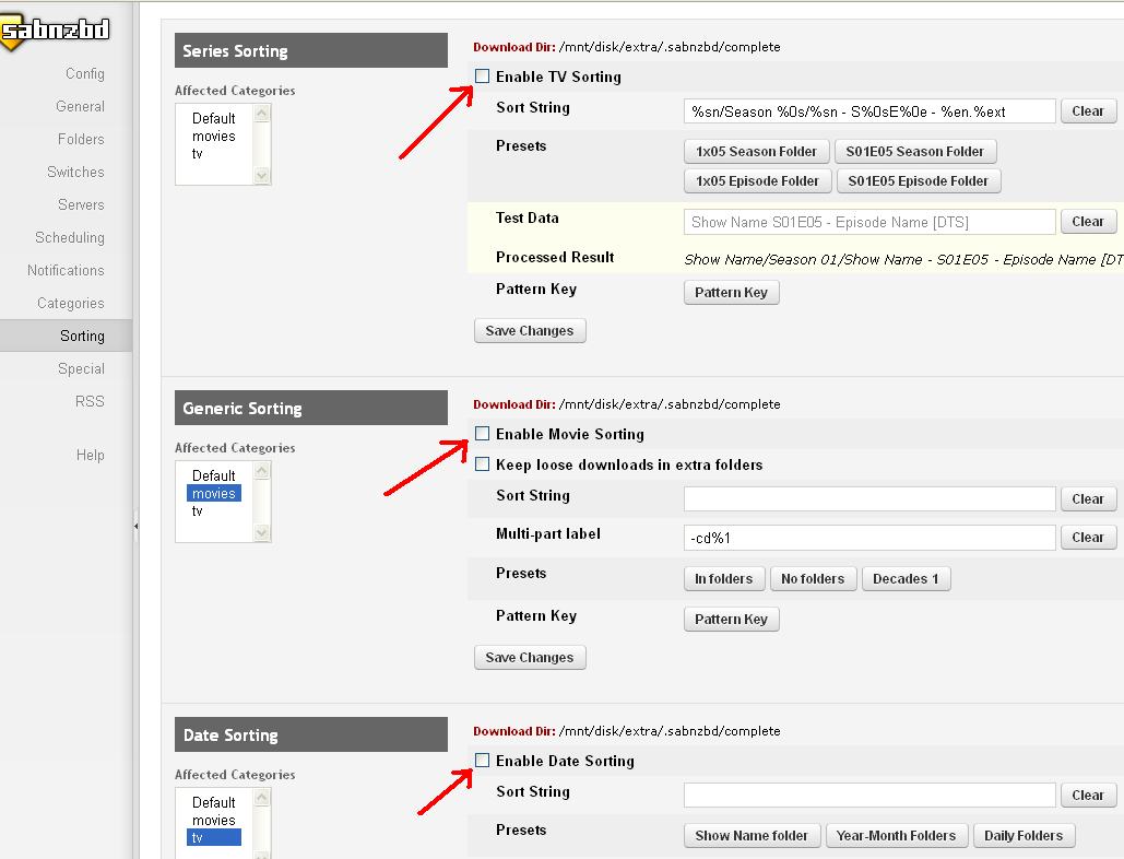

Do I need to enable series sorting in SAB? (See 2nd screen shot.)  I'm thinking not, since it's using the sabToSickBeard.py script in the categories page. Thought I'd bring this up, just to make sure I wasn't missing something critical.

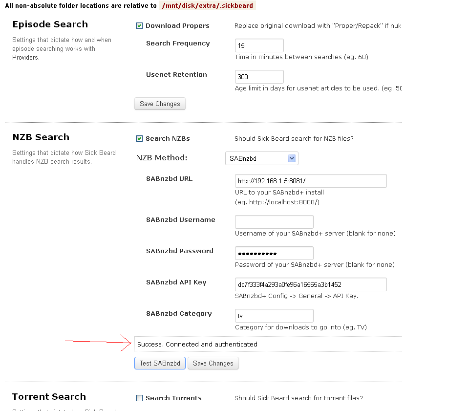

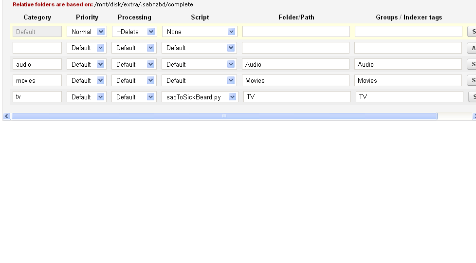

Could you add screenshots of the Sabnzbd general and folders tab, and from sickbeard, the search settings and post processing tab.  I know you've added some of these before, but I'd like to be sure we're working with the latest versions.  Should be easy enough to sort from there.
Thanks again, Beta.

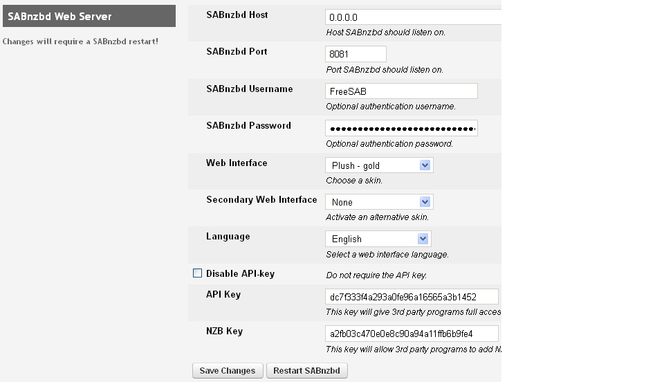

Yes, I do have a user/pwd on SAB. I'm using madDog on my android phone to be able to remotely monitor things, so I've put a pretty long pwd on it.
No problem re-doing the screen shots, I appreciate all the help I can get!
I realized that on the SB Search screen, I don't have my SAB user name entered, though the pwd is there. It works OK, (note the red arrow pointing at the test results), so I'm assuming that it just uses the API key to get access.
You put the wrong user and password into the config file.

I'd also get rid of the 'move associated files' on the sickbeard post processing tab - up to you of course, but it looks like you have XBMC metadata selected at the bottom of that screen, which will add .nfo and .tbn anyways.. don't need all that other rubbish.
