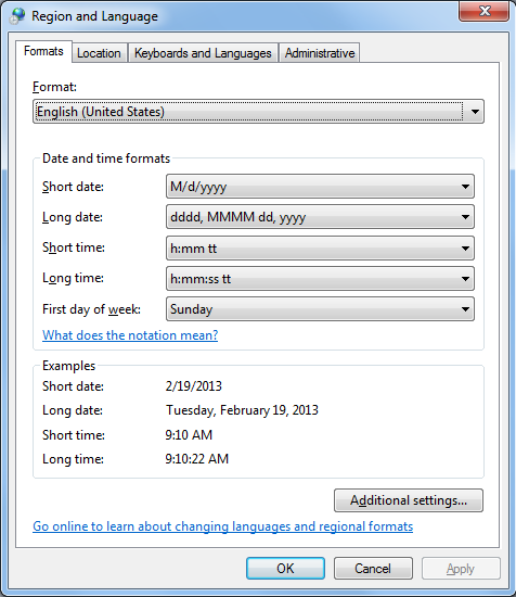

What character set are you using on your PC?

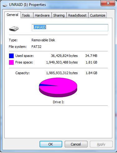

its labelled as UNRAID. I tested it on a lap top w/o the reader and it booted just fine to a clean install of rc11.
Win7 Region and Language is set to English-US.

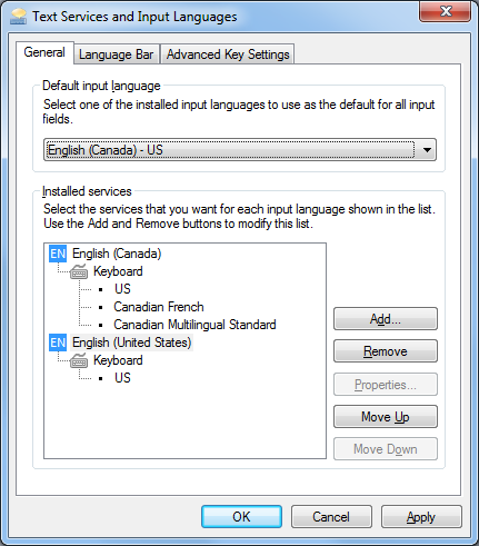

What is the 'Keyboards and Languages' tab settings?
English (Canada) - US
