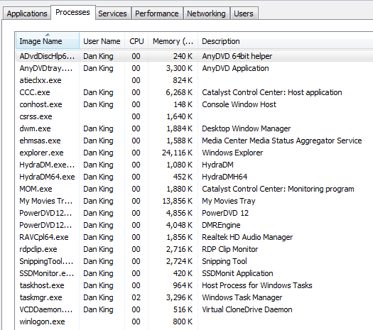

Thanks again madburg.  I shut down .182, my win7pro htpc; spundown all and disk 13 stayed spun down.  Restarted .182 and in no time disk 13 was spun up.  I took screen snip of running processes on .182 before I shut it down and have attached.  I have also attached a new lsof_mnt after restart.  Do either of these provide clues on what might be probing disk 13?
The only thing that has changed recently is that I replaced a bunch of old hard drives with larger new ones and so my photos, etc ended up on a different disk#.  I think I went into Windows Media Center on .182 to reset folder monitoring and point it at disk 13...that is the only thing that has happened recently that I can recall??
lsof_mnt_0855.2.23.2013.txt
ehmsas.exe causing the problem?

If it once again spins back up, attach a new lsof txt for review. BTW that is not ALL the running processes on that htpc, those are the processes of the logged in account, you would want to dump all running processes.

Yes madburg, you are correct about processes, I forgot to click the all users button; I have a screen snip of all the processes that i took after reboot of offending htpc if you think it will help.
