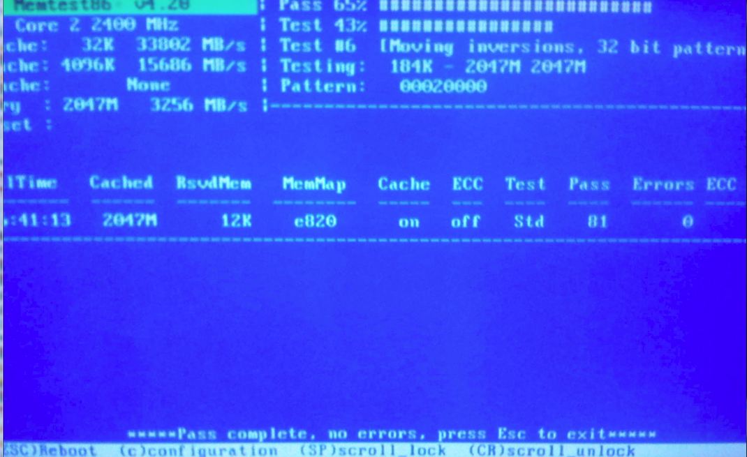

Ps
Memory test seems fine...

In order to rule out hardware, i have run a long smart test and a memory test - both seems clear(see attached)
