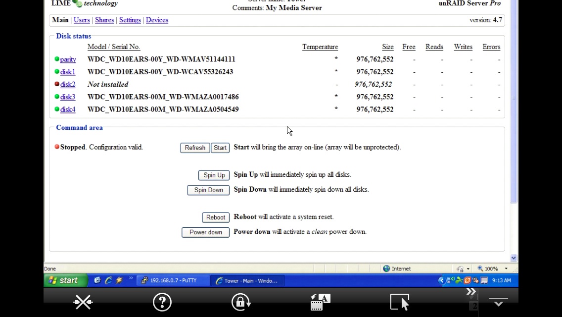

When i turned the computer on i didnt manually assign anything, however, since i connected it to the exact same sata port I supposed unRAID picked up on this since it placed it on the same spot in the array, and the configuration was valid, with the red ball disk.
After i unassigned it, it showed up with a different color (which i dont remember now and not at home to check) but i *think* it even said like the disk had been replaced.
Left home this morning and the pre clear was still running (last phase i think) after about 7 hours.
The other question was if after the pre clear completes i need to reboot or if i can just start the array and unRAID will know it's been pre-cleared?
Edit: ok i remoted in to a computer at home and checked. Still says configuration valid, i could start the array if desired (unprotected) and it shows the failed disk red balled and as "missing". Still a picture is worth 1000 words, so attaching.
Everything looks good, right?
Yes, that looks exactly like it should with a failed disk.  Note that even with no disk installed (in the array), you can still read and write to disk2  :)      That's what fault-tolerance does for you !!
UnRAID will emulate the disk by reading all the other disks plus your parity drive to reconstruct the data (for reads); or will write to the parity disk to maintain the correct parity (for writes).
When your pre-clear completes, you simply assign the new disk to replace disk2 and it will then do a rebuild of the disk [the fact that it's pre-cleared is irrelevant since you're not adding a new disk ... you're just doing that to test the disk].
