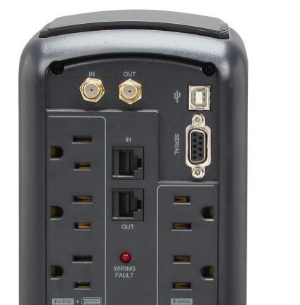

July 6, 201313 yr His cable was from the PC to the UPS? Sure. I have mine all set up the same way. A good UPS should have surge protection for your Ethernet connections (all of my units -- APC and CyberPower -- have that). You plug your Ethernet connection into the UPS, then run a short cable from the UPS to the PC. Here's an example (it's the rear of one of my CyberPower units ... note the "In" and "Out" for Ethernet cables:

July 7, 201313 yr Author His cable was from the PC to the UPS? Sure. I have mine all set up the same way. A good UPS should have surge protection for your Ethernet connections (all of my units -- APC and CyberPower -- have that). You plug your Ethernet connection into the UPS, then run a short cable from the UPS to the PC. Here's an example (it's the rear of one of my CyberPower units ... note the "In" and "Out" for Ethernet cables: Mine has RJ jacks but RJ-11 for the phone/modem, not RJ-45 for ethernet. Didn't even know they came with those...
