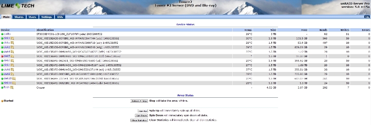

July 18, 201313 yr I have a red ball beside disk5. I replaced the SATA cable and made sure all cables were plugged in. It still comes up red I have attached the syslog syslog.txt
July 18, 201313 yr A drive gets a red ball because a write to it failed. Once that happens the red ball won't go away unless you do something like rebuilding the drive from parity. At least that's my understanding.
July 18, 201313 yr Author Can someone confirm this? What is the best way to get my disk5 green again?
