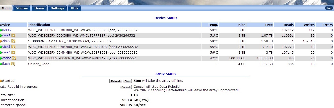

After a little experimentation, I got the disk to be detected as a new disk. So I let it get rebuilt. Now the problem is that its being rebuilt at super slow speed. 24 hours down the line I'm still at 2% of data rebuild. So something is definitely wrong. Please advise. Screenshot and new syslog both attached.

I don't think I am ever going to be able to have a protected array. I have replaced the suspect disk with a brand new disk and the dat re-build is again ~ 1MB per sec.  :-[

your drive temps (according to your screenshot) are way high. check that your fans are all working and cables arent blocking the air flow or the fan.
