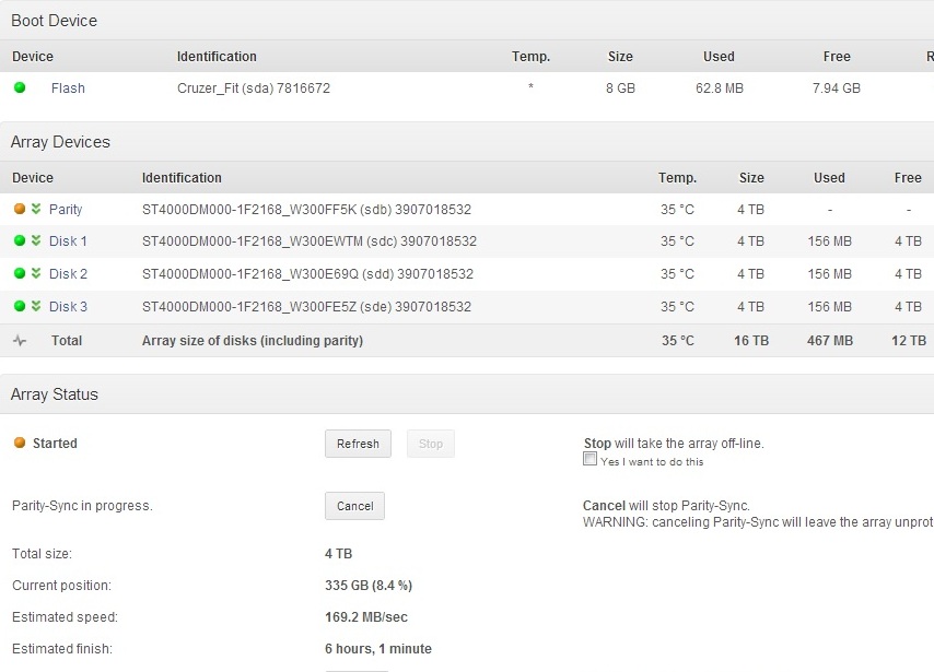

short update: preclearing is done, now it's sync'ing parity at ~170MB/sec, see attached image.

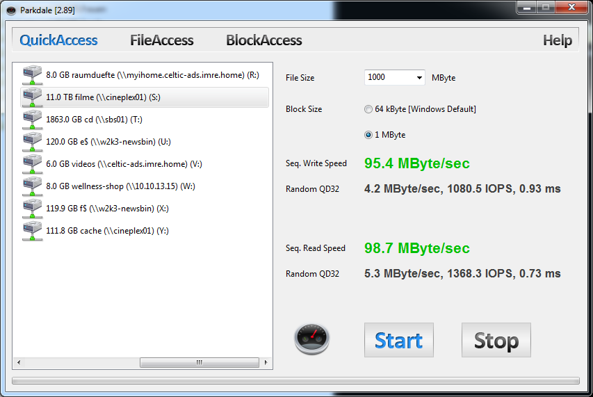

As promised, find some benchmarks attached: without cache disk, with Samsung 750GB as cache disk, with Samsung SSD as cache disk.
I am very glad about these results and I'm a little bit surprised that it doesn't really matter if you use a ssd as cache disk or an old Samsung HD753LJ when writing to the raid. Both are fine for increasing the write speed.

...and after applying that cpufreq-"fix", I wonder why so many people waste so much money on Synology, QNap and Buffalo :-)
The "fix" for the N54L (from some post in this forum) and maybe as well for the N36L / N40L is adding these lines to the go script:
echo 50 > /sys/devices/system/cpu/cpufreq/ondemand/up_threshold & logger Go Script - ondemand up_threshold set to 50
echo 50 > /sys/devices/system/cpu/cpufreq/ondemand/sampling_down_factor & logger Go Script - ondemand sampling_down_factor set to 50
and of course you should execute these 2 lines once (or reboot, whatever you prefer).
That made the benchmark for "writing to the unRaid with cache disk" look like this:
Seq. Write Speed: 95.4 MByte/sec
Seq. Read Speed: 98.7 MByte/sec
Without the fix:
Seq. Write Speed: 54.3 MByte/sec
Seq. Read Speed: 97.3 MByte/sec
The original value for "up_threshold" was "95" on the N54L.... way too high, if you ask me (and the benchmarks :-) ).
