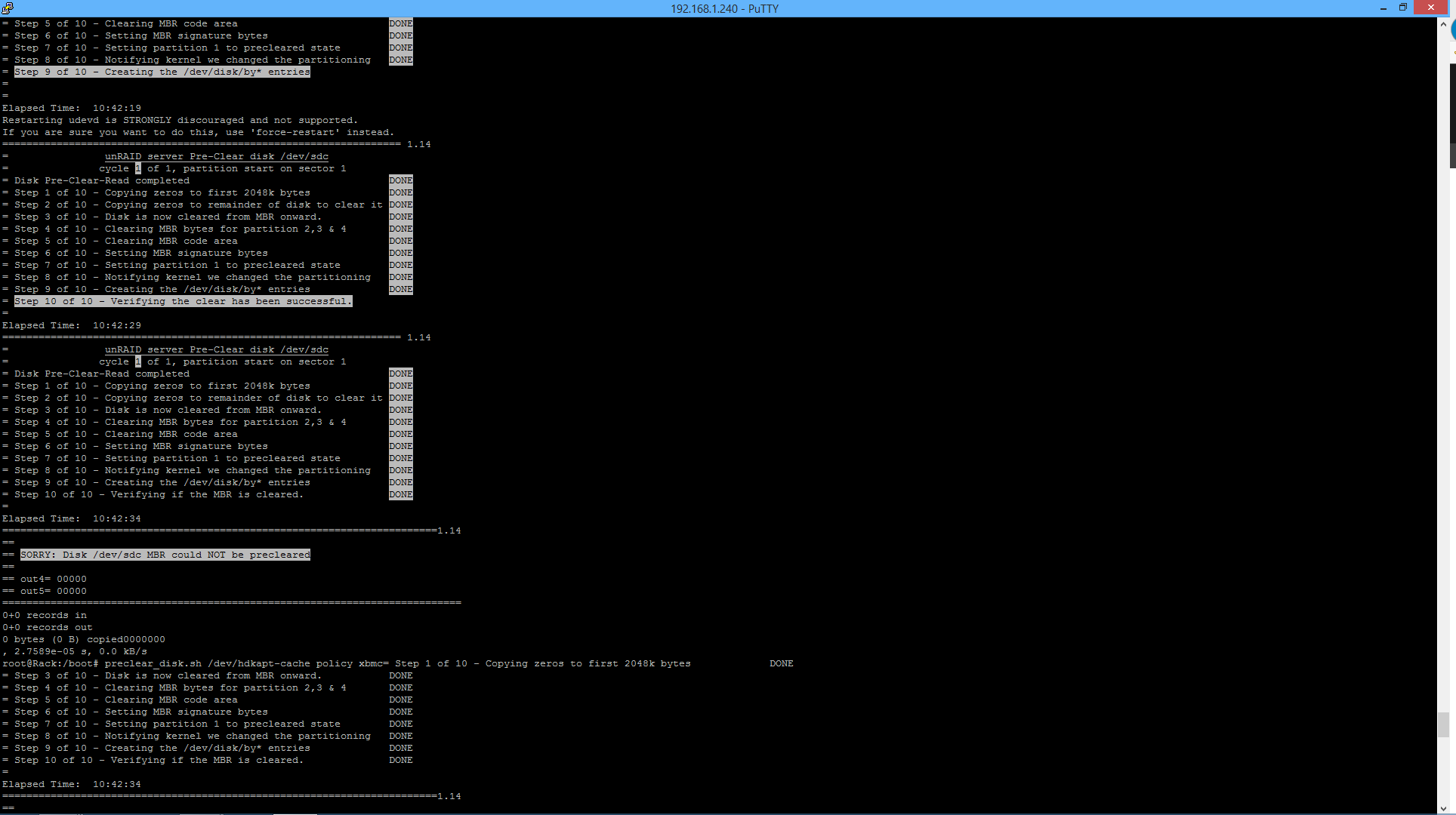

Moved to cables from the working 2TB to the questionable 3TB and tried a preclear again.
Failed at the end.
Attached is the screen shot of Putty.
