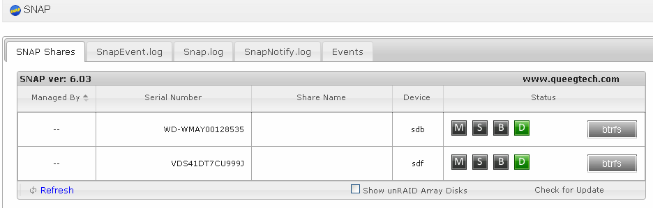

I found three  problems with a new install of SNAP
I had a new 4tb WD drive that I added via SNAP as a test for the proper SNAP operation. Everything was working as expected. I then stopped the array and added that drive to the array.
It was removed from the list of SNAP controlled drives and added to the SNAP list of array drives.
Problem: The drive is still listed as a non-array drive in my network listing of Tower drives on all my Windows computers. So my Unraid machine has 11 drives and a list of 12 drives in Windows Explorer or File Explorer.
How can I remove the Windows Explorer network listing and prevent this from occurring again ?

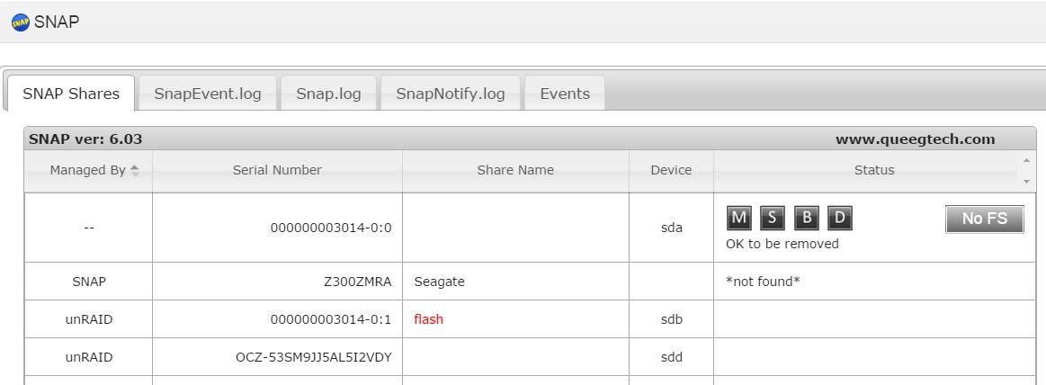

There is a drive listed (attached Snip ) that is not a Snap controlled drive. It appears to be a "duplicate' of my Unraid flash drive as it has the flash drive serial number and states
"OK to be removed " There are no controls for removal and would that then remove the Flash drive as they have the same serial number ?
There is a drive listed as "not found " which was an external USB drive that was removed yet the listing is never updated.
In order to remove a drive from SNAP, you must remove the share name.  Right click on the drive and select "Delete Share Name".  SNAP will then release the drive.
Your flash is listed and is sdb.  The other drive that you think is also your flash is sda and the serial number is different.  3014-0:0 vs 3014-0:1.  unRAID sees two drives mounted and SNAP gets this information from unRAID.
On the Seagate drive '*not found*' you need to delete the share name and SNAP will release it.

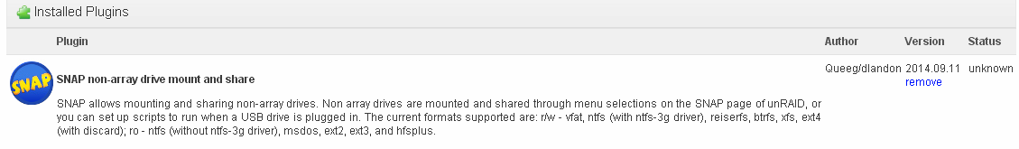

Hopefully not a hijack.  Seemed to be the most appropriate place, being unRAID 6b10a, SNAP version 2014.09.11 (installed via web gui to add plugin, which worked well!), lsblk output is available in the attachments.
After using parts of the [now DEPRECATED] How to partition, format ext4, and mount an SSD outside the array along with the unRAID 6 Beta 6: Btrfs Quick-Start Guide during the unRAID 6b6 period, and having the 'old' 250GB drive that was BTRFS had checksum issues, locking me out of the qcow2 format *.img (unexpected Checksums on access, when attempting to copy/backup the VM virtual disk after applying a few hundred Windows updates) while the Windows 7 VM would still boot fine (had been looking into running Windows Media Center with a Silicon Dust 3 tuner network device, via cable card).
After updating my beta server, from 6b6 to 6b10a, I opted to give a /apps or /vms share another try using an old 2TB WD Black (3Gb/s) that I freed up in the last few months.  I partitioned it as 400GB BTRFS (/dev/sdb1), 500GB XFS (/dev/sdb2), and 963GB ext4 (/dev/sdb3, being the remainder of the drive)... SNAP sees the device (drive) as BTRFS (being the format of the first partition).  To me, this feels like it may be a "by design" item, rather than an oversight (or reasonable enhancement). After all, SNAP is stated for mounting/sharing DRIVES outside of the array, not partitions.
Do others agree with the "by design" conclusion?  If so, I'll be heading back to pursue the /boot/config/go & /boot/config/smb-extra.conf avenue.
SNAP only mounts the first partition it finds.
