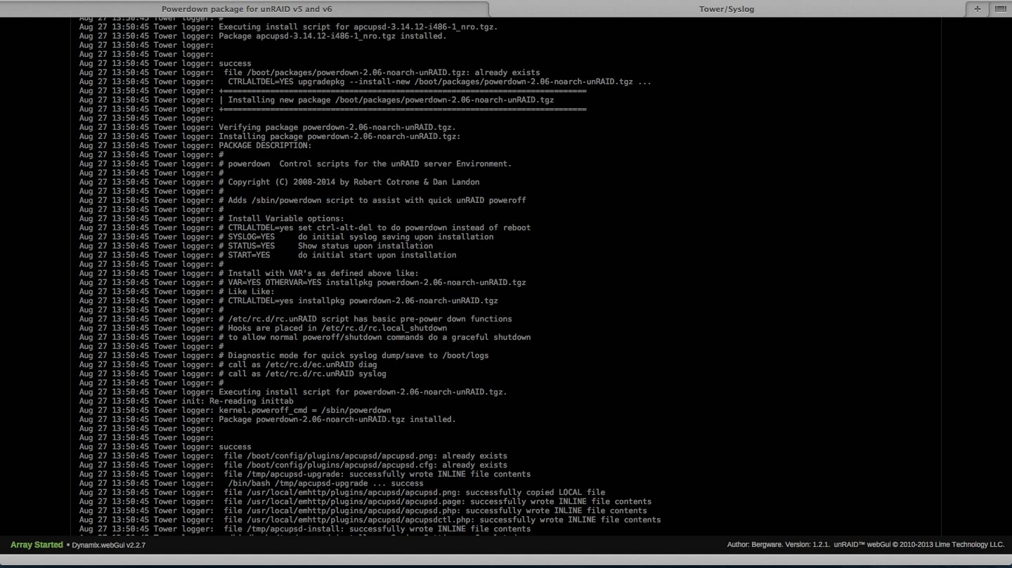

Seems like we are getting somewhere. So Dynamix could be causing me the problems. Here is a screen shot that mentions your name but it looks like its still on 2.06. Its pointless booting in safe mode because I need the APC UPS script and powerdown. I found the same when adding cache dirs from Dynamix. I don't know what is going on but people seem to be changing plugins all the time and it drives me crazy if revision numbers are not in there. I added Joe's Cache Dirs script outside of Dynamix. To be honest I do really like Dynamix especially in the back theme but hardcoding someone else's script into it doesn't really make sense.
No I don't see a direct connection with Dynamix, that was just a side note to others.  The only issue here with Dynamix is that it makes it harder to revise Powerdown.
While I'm flattered to be confused with such a great person as Robert Cotrone (our beloved WeeboTech), I can't usurp his prestige and fame!  ;D  My name isn't mentioned anywhere there.
I didn't realise that was WeeboTech's name and thought it was probably yours. My mistake. Sorry WeeboTech. So I have added you file to my boot directory and also added the command to the go file and still no luck. Is anyone else trying this while using Dynamix or is everyone on the stock WebGui.
can you provide the screen shot of the last few screens as the machine shuts down.

A side note, I created a Powerdown 2.07, but Dynamix appears to have Powerdown 2.06 hardwired (the name powerdown-2.06-noarch-unRAID.tgz is hard coded in it), so 2.07 was 'upgraded' to 2.06.  Perhaps renaming it as the former would work, but I find that an unacceptable practice.  In addition, I discovered that my powerdown-2.06-noarch-unRAID.tgz is not the same as the one currently downloading from the git repository.  Mine has files dated Mar 1, 2014, and the current one has files dated Mar 4, with 2 important files within having been revised.  The revisions aren't major, but whoever did that (making code changes but leaving the names and version numbers identical), consider this a slap on the hand!  ;)
Dynamix webGui has a reference to Powerdown 2.06 on github in the PLG file. This gets loaded first. If you want to upgrade to a later version (which by the way is not in the github repository), you can install the separate Powerdown PLG either manually or place the PLG file in '/boot/config/plugins' and reboot your system. It *should* upgrade the version to the latest, though proper naming of the PLG file is relevant here.
