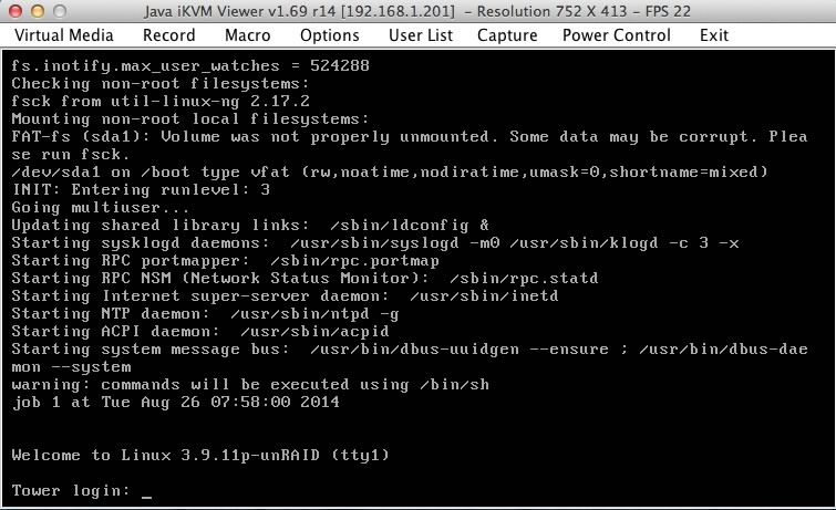

Sorry I have tried it and its not working for me RobJ. Here is a Screenshot after check the go file again and the script name. I have also included my syslog.
syslog.txt
can you provide the screen shot of the last few screens as the machine shuts down.
the sync should insure all blocks are written, so perhaps something has the filesystem busy and it cannot be unmounted.
Can you confirm that this syslog is after a second reboot?  That is, did you reboot a second time after installing the mod, so that you could obtain a syslog *after* it had run the revised Powerdown?
It's a little confusing at the moment, since I only revised one file, and the package still identifies itself as Powerdown 2.06.  I should have created a Powerdown 2.07, but wanted testing, and didn't want to 'intrude' on those currently maintaining it.  And my last instructions were not complete, as to mentioning the need after rebooting to shutdown or reboot again using the revised Powerdown 2.06a, then check the syslog.  I should also mention that it would be good to run Check Disk on the flash drive, to clear up any more serious issues with the flash drive file system.  If it were only a status indicator (a dirty bit), that should be reset by subsequent usage.  But if there was a failed write to a file, then there may be more serious issues to correct.
It was actually after a third reboot as a copy and paste of your go file command put two spaces where I presume from all other Linux commands should have one space. Another user suggested I should run chkdsk on the flash card after installing and rebooting. I will have to get a windows machine to do that on.
I usually put 2 spaces in commands visible in posts, when they might be typed by some instead of using cut-and-paste.  Only one space tends to be almost invisible, and more spaces don't matter.

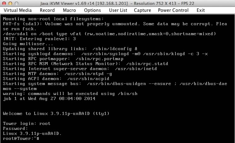

I have reinstalled the script RobJ, rebooted twice, shutdown, removed and repaired my Kingston Mobilite G2 with 8GB Sandisk Micro SD card in an SD adapter with Mac OS X Disk Utility and Im still getting the error. It is possible that Disk Utility is not repairing it like chkdsk does but not according to other Mac OS X users. Attached is my KVM screen after the third reboot/restart and my Syslog at this time.
syslog.txt
If Disk Utility is not fixing to flash then something else is wrong. After running Disk Utility on the flash and properly ejecting the flash from the Mac, the next boot of the system should not have the message.
