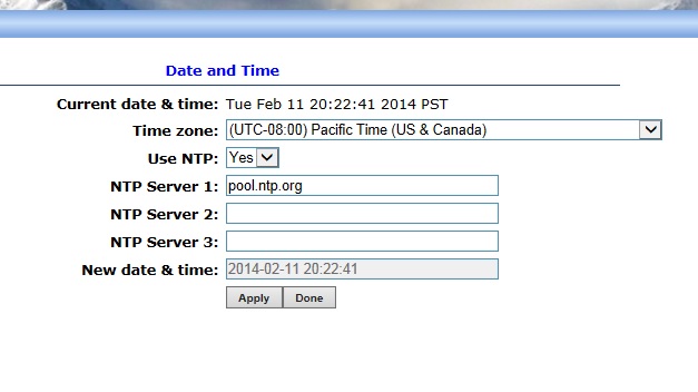

I'm the person responsible for the 64bit conversion of the apcupsd plugin.  I do not get this error on my system.  Can you tell me exactly what it says on your Date and Time settings page in emhttp ... particularly what appears on the "Current date & time:" line.
attached is a screenshot of my Settings --> Date and Time page in the stock gui.  I hope that is what you meant.  If not, let me know.
Yes, that is the settings, And I have timezone set for Sweden, but I could try with your timezon to see if it this messages are gone?
Cant try it right now,  can do it in the weekend, but if you do not see this, then I shall try to change to the timezone you use ;-) and see if it's OK for me as well.
But We might need Tom take a look at this! I have posted the issue in V6 beta3 thread, it must be something broken for php and Timezone
@PeterB Can you try to change timezone ( UTS +1) and see what happens!
