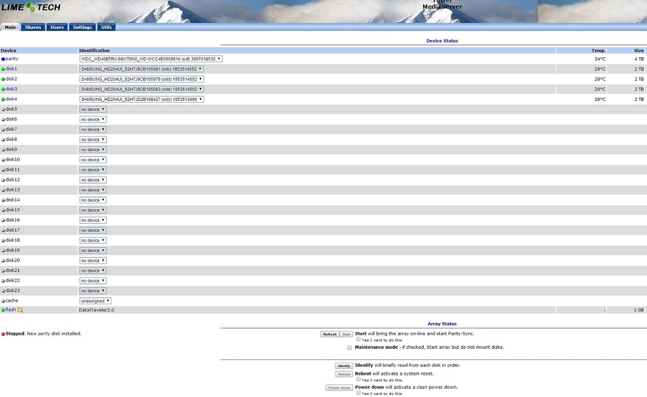

I've had my 4x2tb data plus 2tb parity drive on unraid 4.7 running for over two years, recently upgraded to 5.0.5 for a month and all is great.  Until...
Invested in a set of WD red 4tb drives for a straight swap, double capacity upgrade.
Tonight, I stopped the array, unassigned the 2tb parity drive, powered down, took the WD red 4tb out of it's sealed bag and replaced the parity drive. Booted, chose the WD 4tb as the parity.  Drive status was blue.  Tried to start the array, but it won't, just get the 'spinning up all drives' message but the array hasn't started.
Stopped. New parity disk installed.
is the message under the disks.  I've refreshed, re-booted, started started... still no go.
Below is the syslog after I try to re-start again.  Any experts have any idea?
thanks
CTID

Not sure what your current problem is. Maybe a screenshot would help.

Dumb question, but did you first click the checkbox for "Yes I want to do this" so that the "Start" button will change from Grayed-out to Normal?
After clicking the box, you can then press the Start button to "bring the array on-line and begin Parity-Sync".
I put the array on line without parity just to make sure that the new HDD was the cause.  Once it was on line, I took it down again.
Yes, definitely set as parity.
That's a good spot from the screenshot .... it may well be all that is needed here!

Ha!  I said I was a novice not a dim wit!!!  Yes, I know how to start the array.
