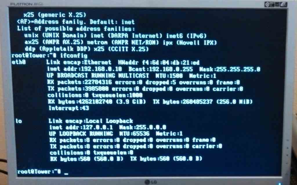

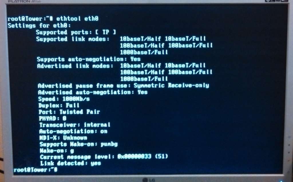

Post the results of
ifconfig
and
ethtool eth0
Screen shots are attached. Sorry made with cell phone. Looked into ways to do a screen capture, but from what I googled it  involved running scripts etc. and got over my head quickly. That might be a battle for another day.
Nothing obvious from your photos. Maybe someone else will have an idea.
