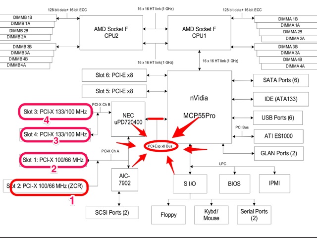

Hey y'all,
I've just started setting up a supermicro H8DME-2 based server from Tam's Solution (w/ 24bay 4U supermicro case, 2x quad core cpu and 16gb ram) and migrated my old 19-drives unraid server which was housed in a Norco 4220 case to it. First, the good news... everything booted up normally and all I had to do was start the array to get things running, but once I started the parity check, I was really disappointed to see that it was only hitting 15-20MB/sec whereas I've read post that Tam's server should hit 105MB/sec-ish without any changes.
I have 19 drives, about 2/3 are 3 or 4TB ones which clock in at 130-150MB/sec each (on hdparm -tT), and the slowest ones are WD 2TB EARS which go for 100-105MB/sec. These same set of drives were getting parity check speed of 55-65MB/sec from the get go (and goes up to 90-100MB/sec above 2TB) in my Norco setup.
I've played with the disk settings to no avail (md_num_stripes at 2048, md_sync_window at 1280). There are no AHCI settings in the bios and I've disabled the IDE and SATA controller anyway, since no drives are connected to the motherboard. Copying files from a windows machine to the server, I got 33MB/sec.
Things to try:
- I have yet to disable int13h on the SAT-MV8s.
- I haven't updated the BIOS to 3.5a
I've also noticed that the openwyrn-openssh.plg plugin takes a helluva long time to start up (nearly 10 minutes). It may have always been like that in my old Norco setup, but if so I didn't realize it since the machine hardly ever reboots.
What am I doing wrong?
How can I speed things up?
Thanks

The parity check speed stays around 16-20MB/sec whether I do completely nothing on the server or when I put slight load on it (stream a movie off it, run preclear). Currently I'm preclearing a 4TB disk (started at 148MB/s, now it's hovering around 96MB/s at the 3TB mark).
I will try a firmware update and post an update here again.
I've flashed the motherboard's firmware to the latest one (3.5a) and there doesn't seem to be any difference at all. There are no newer firmware for the SAT2-MV8 cards either.
Parity check maxed at 21.6MB/s just now and curiously it seems to be really tying up the /mnt/user share (shfs). I tried to do a syslog dump to /mnt/user/syslog.txt and it just hung there for minutes, until I cancelled parity check.
Attached is the syslog (w/ parity check start and stop) and also a `ps -aux` dump.

I've dropped the RAM from 16GB down to 4GB.
I've moved the SAT2-MV8 cards so they each get their own IRQ: (compare sata_mv assignments to the one above)

@dgaschk, zeroK, BobPhoenix: thanks a lot, guys. All signs pointed to bus bottlenecking, but i remembered a few posts about this server in which ppl mentioned that they're ready to use (without mods) and that people have gotten 105MB/s parity check speed.
I've also read that PCI-X should do 1GB/s at 133mhz and 800MB/s at 100mhz (which should enable at least around 100Mb/s per drive on Sat2-mv8's max capacity, which is 8 drives per controller).
It didnt make sense to me, until i went back to the manual and studied the diagram:
PCIex8 moves about 2GBps. It easily accommodates 1000MBps + 800MBps. The issue is that PCI-x slots share the bus capacity. One of the busses has 2 cards and 16 drives can use more than 1000Mbps. If the system had 2 cards it would have acceptable speeds. How many PCI-x cards are the people who are getting 105MBps using? How many drives are connected in those systems? The third card is killing performance. Replacing one of the cards with a PCIe card should substantially improve performance.

Ah alright. I'll try 1 pci-x card per bus. Whatabout the onboard sata connectors (nforce chipset)? Those usually operate full speed, right?
I'm still baffled.... here are the stats from my tests, through some changes of HBA configs... last one I start to use the onboard controller. I'm waiting for SFF-8087 breakout cables before I can deploy M1015s into the mix.
