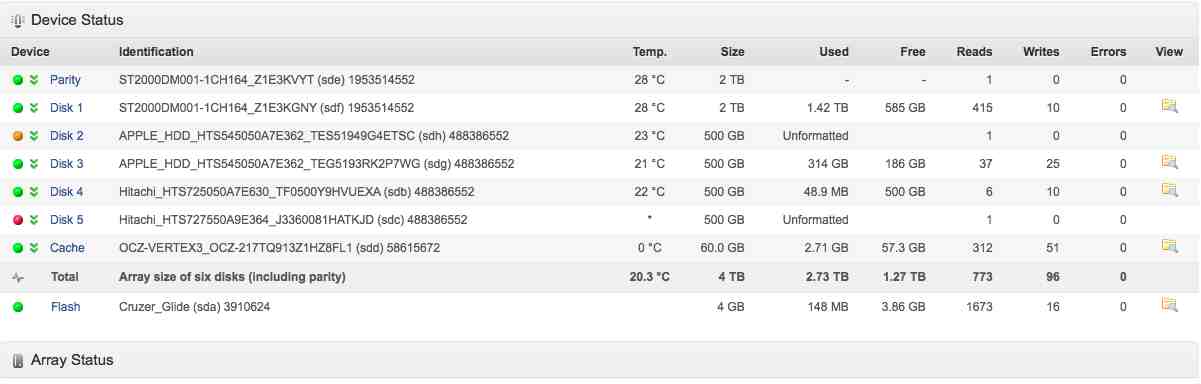

Your screenshot shows both drives unformatted. That means that unRAID cannot mount the reiser partition. Drive5 is also red. That means unRAID failed to write to the drive, and so now thinks it needs to be rebuilt.
Go ahead and check all of your cables and power connections and see if you can get at least drive2 recognized again. Don't do anything else without further advice.

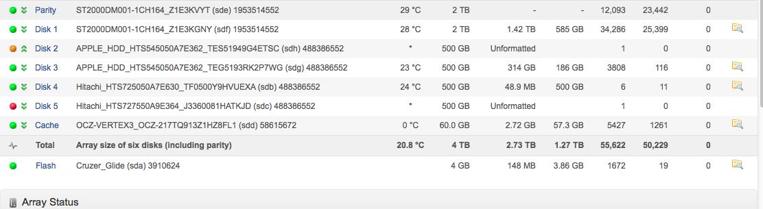

If disk2 is still showing as unformatted, then unRAID can't be reading from it. Maybe it is simulating it from parity and the other drives. Is disk5 still showing as unformatted as well, or just redballed?
If anything is different from your previous screenshot, post a new one.
Screen shot still looks the same.
I assume its running off of parity.
Should I just accept my loss? Or is there hope.
I don't see how it can be simulating one drive with another drive still missing. It takes the parity data plus all of the corresponding data from all of the other disks to be able to recreate the data for a single drive.
