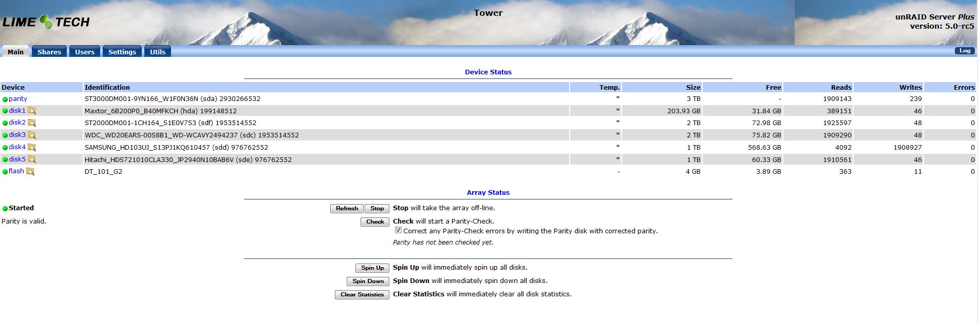

I did that, when I selected the new drive it still said 'wrong'.
Screen shot attached.
That screenshot does not say it is wrong!  It says that unRAID has accepted the drive and is rebuilding the contents of the old drive onto the new one.  If you are talking about the colour of its icon, then it is currently orange because the rebuild is in progress, and the icon will turn green when it has finished the rebuild process.

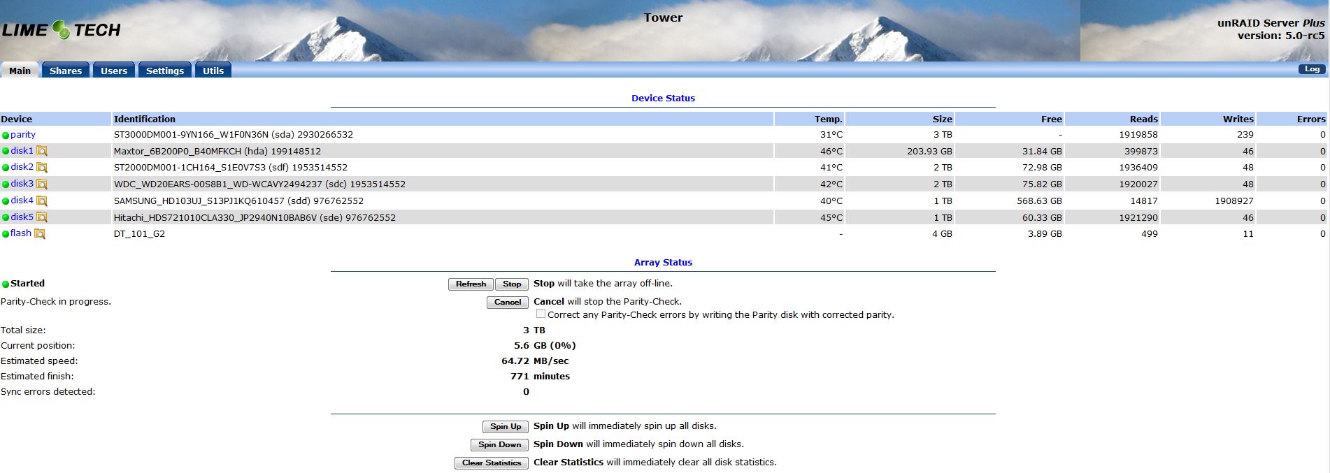

Hi, thanks for the info, please find attached the latest screen shot.
Many thanks,
Danny
Your screen shot shows you are running 5.0 release candidate 5!  the latest version is 5.05.5!  You are approximately 20 versions behind.

@ trurl, I've started a parity check as suggested ( screen shot attached).
Thanks,
Danny

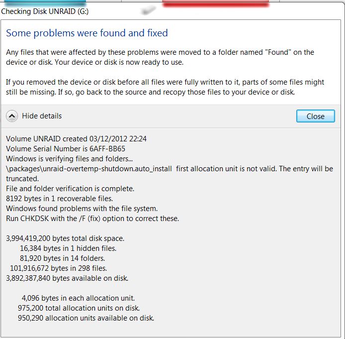

I ran a check on the usb key and it seemed to find a problem with one of the files.
Please find attached a screen shot of the scan error.
Thanks,
Danny
OK. Had to review the thread since it's been a few weeks.
I think you should be OK to go ahead and try to boot from the repaired flash. It may be that it is still expecting the old disk4 and will say it is wrong. If so, since you already did a rebuild and parity check, you should be able to New Config and Trust Parity.
Go ahead and boot and when you can get to the webGUI post another screenshot before you proceed.

I'd suggest deleting the affected file and re-downloading it via unmenu.

For that file, no download is needed.  Just set that package to NOT re-install on re-boot. (that will delete that .auto_install file)
and then set it to re-install on re-boot.  (That will re-create the file)
