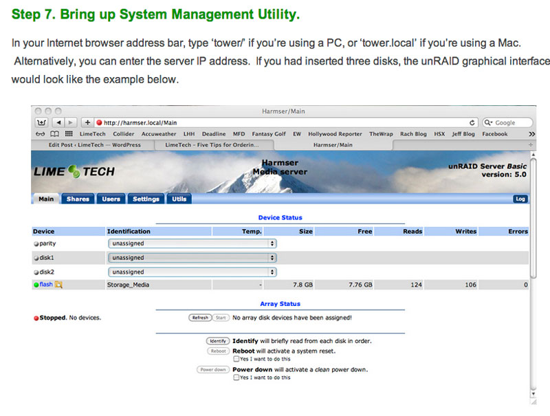

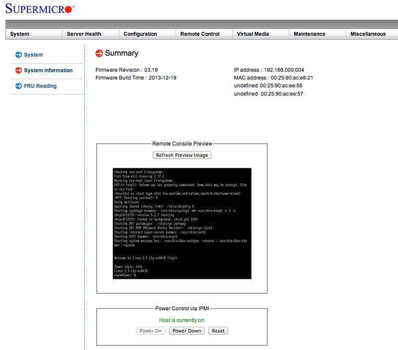

August 1, 201412 yr This is my first setup of unRAID sever and I was able to make one finally. After I precleared all disks and tried to boot the server. It went o.k. with no problem. I tried to access the sever from my mac using ip address. The setup tutorial (http://lime-technology.com/basic-setup-tutorial-for-the-avs-104-mass-storage-server-with-unraid/) says that I would get the following picture (after-preclear-1.jpg). But actually I get different picture (after-preclear-2.jpg). My question is how to get to the system management utility page as shown on after-preclear-1.jpg. I am somewhat puzzled and any help would be greatly appreciated.
August 1, 201412 yr I think you have used the wrong IP address? It looks as if you have accessed the IPMI port on the SuperMicro board. This is a special port that allows you to get at the BIOS facilities while the board is booting. There will be a different IP address (using a different physical LAN connection) that is the normal Ethernet connection.

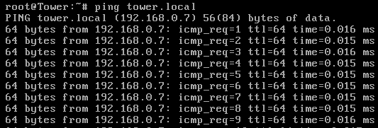

August 1, 201412 yr Author I can ping to tower.local but typing "tower.local" on browser is not working.

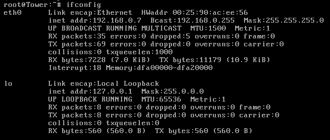

August 1, 201412 yr Since you were able to do preclear then you must be able to get to the unRAID command line, whether through telnet or IPMI or whatever. From the unRAID command line, what do you get with ifconfig ?
August 1, 201412 yr You have your ethernet connected to the direct access SuperMicro port on the mother board and that will not allow you to connect to Unraid You should have additional ethernet ports ports available on the rear of the server. Move your cable to one of those and then try accessing the server use 192.168.0.7 as the ip address

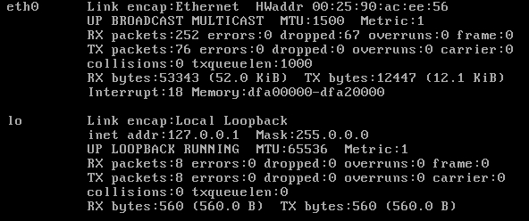

August 1, 201412 yr Author There are two ethernet ports: LAN1 and LAN2. Initially it was connected to LAN1 and you are suggesting me to connect to LAN2. After I use LAN2 instead of LAN1, I can no longer access the server through ip. I can not ping tower.local either. I am attaching the screen shot for ifconfig of LAN2.

August 1, 201412 yr Yes, 192.168.0.7 is the ip address of unRAID according to your screenshot ifconfig. When you ping tower.local, does it come back with that ip address?
August 1, 201412 yr Author http://HTTP://tower.local is not working. The following is the screen shot for ping
