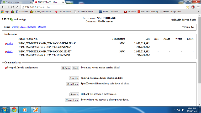

I upgraded my two drive unraid system the other day. i had two drives 500gb each. parity 500gb disk1 500gb. i upgraded both with 2tb drives (parity 2tb disk one 2tb) all was good until one day i moved my unraid system and i have damaged my usb stick. to the point were i cannot boot from it or get files off of it  and i dont have a copy of my files. the only copy i have is a old backed up copy when i had my 500gb setup. i have a new usb stick now and i put my backed up files onto it and it booted ok however when i login to unraids web gui it says Too many wrong and/or missing disks!
i have gone into disc devices and set the correct parity drive and disk1 as luckily i remembered there serials but my unraid wont let me start the array.i dont even see any options
i will attach pictures and my usb boot files. i really hope someone can help me out as i hope i haven't lost all my files in my shares
i have unmenu installed if this helps
unraid 4.7
You will have to do a new configuration. You will have to search on how to do that with 4.7. I think it might require you to do it from the command line.
Better yet would be to do a new install of the latest unRAID and start from scratch since you have already lost your configuration. Just make sure you don't assign your data disk to the parity slot and you will be OK.
that sounds like a good idea. do i simply install the latest version of unraid onto a usb stick then copy my share files over to it ?

If not then I would think the easiest thing to do will be to create a new USB stick with the 5.05 release installed on it.  You can then assign the drives as you want.  UNRAID will detect that drives already have data on them, so when you start the array you should immediately see the data.    If any drive shows as "Unformatted" do NOT format it as this means you probably messed up in some way, so check back here for guidance.
Thakyou ok so ill install latest version of unraid onto new usb stick and boot from it.
i had a couple of share folders. am i right in thinking when i boot with a new version of unraid wont know i have any share folders but this would be ok ? or do i copy my share files into the new usb stick ?
Any shares you had will be there, but they will have default settings. You will have to go into the webGUI and change them if you don't want the defaults. You can use your backup to examine the .cfg files in the config folder and in config/shares to see how you had things set before.
Thankyou. i have installed latest version and im now booted into unraid 5.0.5
i have selected my parity and disk1 is it safe for me to click start ?
OK i started it and i can now access all my share folders. Thank you so much for your help. i am so happy now i have my files back and my nraid back up and running
