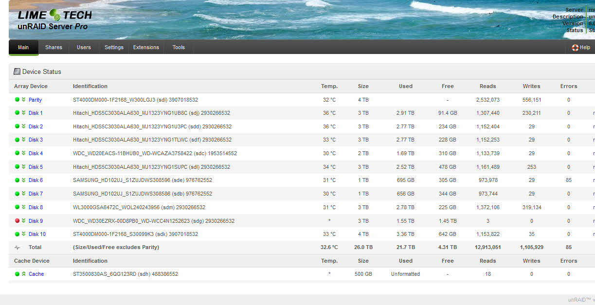

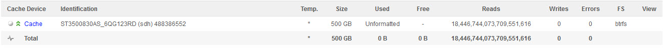

I just realized the picture i uploaded had cut off the formatting section, not sure why.
But, yes, it still shows btrfs.  I just checked it, and it's definitely not doing well (see attached).
I had tried to copy a file in windows, and it failed, then I realized it was probably trying to copy to the cache.  It apparently tried really, really hard  :o

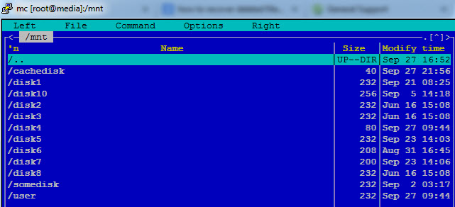

but MC does (see screenshot)
I'm going to try umount somedisk, and see if that clears both of them, and if not, I suppose I have to restart unRAID, and mount them again, but with more caution!
MC is only seeing the directory, but the disk isn't mounted on it.  I don't think the mount worked when you mounted it..
