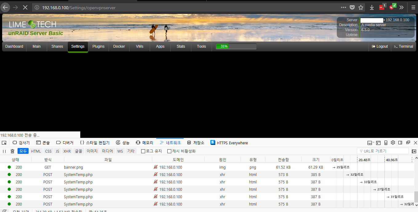

Hi @peter_sm, just posting here to write about an issue with OpenVPN. This sounds really weird...
So after moving to China, the settings page for OpenVPN will not open.
Yes, I have physically moved to China, and the server came alongside. Everything works except for the OpenVPN settings page.
What happens is, every few seconds, I see a request for SystemTemp.php in Firefox Developer Tools (Network pane). This keeps repeating for about a minute before it eventually times out. When it does, all I see is the header for the server and no content underneath.
I am guessing that the Great Firewall of China is blocking a script or something that the page requires - thus it never loads.
Can this be changed so that the page loads regardless of script results? Thanks. And what's the script trying to do in the background?
It could be the function to get your WAN  IP on this address --> icanhazip.com
Or the new function to get info from easyrsa github project --> https://github.com/OpenVPN/easy-rsa
//Peter
Thanks for the quick answer! I tried the first link and it wouldn't load. I have no idea why the GFC blocks a IP address website *shruggie*
GitHub works fine in China without a VPN, so the second function should probably work.
Regarding the WAN IP, I have my own domain pointing to a DDNS service that routes to my server (kinda mandatory because China keeps switching my residential IP address), is there an option so it stops polling an external service? It can read the IP from my subdomain. If that doesn't work, maybe a fallback website could be implemented?
EDIT: Possible fallback: https://api.ipify.org/

Can you check latest update ? maybe needs a reboot to get all in place !
 the file
/var/local/emhttp/plugins/openvpnserver/check-my-ip.sh
should looks like this now
#!/bin/bash
if ping -c 1 icanhazip.com  &>/dev/null
then
        curl -s --max-time 15 --silent icanhazip.com
else
        curl -s --max-time 15 --silent  https://api.ipify.org/
fi
Still not sure what's the problem. It won't load.
I tried going to both websites and they all work now, so I'm pretty certain it's not the IP checking feature anymore. The same problem occurs.
What does that easyrsa script do, exactly?
It creates all the server/clients keys and certificates
Can you ping google --> 8.8.8.8
I just tested it, surprisingly yes.
Any other causes for this problem? What could I help to debug? I'm on latest 6.5.0 if that helps, though this problem was there before (6.4.0)
Edited by Guest

Can you telnet in and run this command and see what happens?
/etc/rc.d/rc.openvpnserver restart
And
/etc/rc.d/rc.openvpnserver getonlineversion
Edited by peter_sm
DNS resolutions can take up to 24 hours to propagate. Wait a few and try again
I setup that new ddns at least a month ago, so I'm thinking that's not the problem at this point
Running the first command:
root@derrickserver:~# /etc/rc.d/rc.openvpnserver restart
Stoping Openvpnserver.....
... Stopped
Deleting iptables rule ....
Starting Openvpn server.....
nohup: redirecting stderr to stdout
OK... Started
Adding iptables rule .....
br0
11       0     0 MASQUERADE  all  --  *      br0     10.8.0.0/24          0.0.0.0/0
Running the second command took a long time, but eventually:
root@derrickserver:~# /etc/rc.d/rc.openvpnserver getonlineversion
So something's going funky with the second one. What's going on?

Second one was an unused function, this is now removed in latest update. Please try and let me know :-)
Update worked like a charm, it now loads correctly. Thank you so much! ;)
EDIT: I realized why it didn't work. I looked at your commit, and the function calls the OpenVPN site. China blocks all VPN sites and sends a TCP RST packet to the script, so it'll keep retrying until eventually timing out. Just in case you were wondering why that function stopped my specific use case. Thank you for fixing it!
