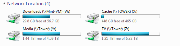

One thing I would recommend is also mapping your cache drive in Windows so that you can watch the usage as you perform writes. I find this useful in knowing both a) the mover is functioning as intended, and b) watching the usage of the cache drive on "big write" days when a few hundred GB might need to be moved.
Screenshot example attached.
