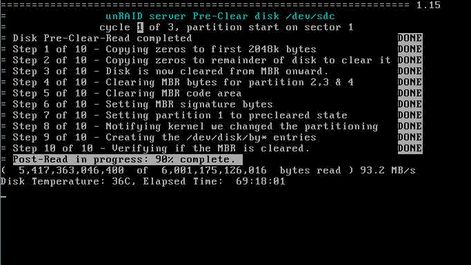

Are such variances typical? (e.g. CPU loads, etc)
What's worrying is that a 3rd Red 6TB that I am pre-clearing right now,  seems to have an even worse zeroing time (Pre-read + 75% zeroing @ 36 hours elapsed). Despite buying this 3rd drive 3 weeks after the previous one, it still has the same 20th October 2014 manufacturing date.
Some other observations:
- I've played around using different SATA ports. The preclear was completed on the board's SATA port.
- Pre-clearing on the LSI SAS controller stalled once, and another time zeroing slowed down to about 24MB/s. LSI controller had no problems with my existing drives.
- Multiple HD Tune benchmark showed no read/write speed anomalies. Starts at about 170+MB/s and steadily drops to about 70MB/s at the end of the drive.
Is this a problem? Or am I just looking too much at these pre-clear timings?

The first Red 6TB
========================================================================1.15
== invoked as: ./preclear_disk.sh -A -c 3 /dev/sde
== WDCWD60EFRX-68MYMN1
== Disk /dev/sde has been successfully precleared
== with a starting sector of 1
== Ran 3 cycles
== Using :Read block size = 8388608 Bytes
== Last Cycle's Pre Read Time  : 13:21:05 (124 MB/s)
== Last Cycle's Zeroing time  : 12:07:27 (137 MB/s)
== Last Cycle's Post Read Time : 26:19:26 (63 MB/s)
== Last Cycle's Total Time    : 38:27:52
== Total Elapsed Time 128:41:48
== Disk Start Temperature: 33C
== Current Disk Temperature: 37C,
** Changed attributes in files: /tmp/smart_start_sde  /tmp/smart_finish_sde
                ATTRIBUTE  NEW_VAL OLD_VAL FAILURE_THRESHOLD STATUS      RAW_VALUE
      Temperature_Celsius =  115    119            0        ok          37
No SMART attributes are FAILING_NOW
0 sectors were pending re-allocation before the start of the preclear.
0 sectors were pending re-allocation after pre-read in cycle 1 of 3.
0 sectors were pending re-allocation after zero of disk in cycle 1 of 3.
0 sectors were pending re-allocation after post-read in cycle 1 of 3.
0 sectors were pending re-allocation after zero of disk in cycle 2 of 3.
0 sectors were pending re-allocation after post-read in cycle 2 of 3.
0 sectors were pending re-allocation after zero of disk in cycle 3 of 3.
0 sectors are pending re-allocation at the end of the preclear,
    the number of sectors pending re-allocation did not change.
0 sectors had been re-allocated before the start of the preclear.
0 sectors are re-allocated at the end of the preclear,
    the number of sectors re-allocated did not change.
== invoked as: ./preclear_disk.sh -c 1 -w 32768 -r 32768 -b 1000 /dev/sdh
== WDCWD60EFRX-68MYMN1 xxxxxxxxxxxxxxxxxx
== Disk /dev/sdh has been successfully precleared
== Ran 1 cycle
== Using :Read block size = 32768 Bytes
== Last Cycle's Pre Read Time  : 21:25:09 (77 MB/s)
== Last Cycle's Zeroing time  : 12:19:57 (135 MB/s)
== Last Cycle's Post Read Time : 35:46:00 (46 MB/s)
== Last Cycle's Total Time    : 69:32:05
== Total Elapsed Time 69:32:05
Switchman I think you might be on to something - my first preclear was done while I was away on vacation, hence absolutely no other activity such as Plex.
Heh 3rd WD 6TB finished preclear, on Christmas.
MERRY CHRISTMAS!!!
== invoked as: ./preclear_disk.sh -A -c 3 /dev/sdc
== WDCWD60EFRX-68MYMN1  WD-WX21D947NSHF
== Ran 3 cycles
== Last Cycle's Pre Read Time  : 13:31:58 (123 MB/s)
== Last Cycle's Zeroing time  : 16:16:42 (102 MB/s)
== Last Cycle's Post Read Time : 26:38:58 (62 MB/s)
== Last Cycle's Total Time    : 42:56:39
== Total Elapsed Time 159:15:54
== Disk Start Temperature: 31C
== Current Disk Temperature: 35C,
I've seen fairly notable differences on pre-clears as well.    While they're not CPU-intensive operations, nevertheless the bus activity is notably different based on just how much activity is going on with the other disks.    So if the pre-clear is the only activity, it'll likely be appreciably faster than if there is a lot of UnRAID activity ... or even if you have multiple pre-clears going on at the same time.
... in short -- I don't think there's anything to worry about  :)
