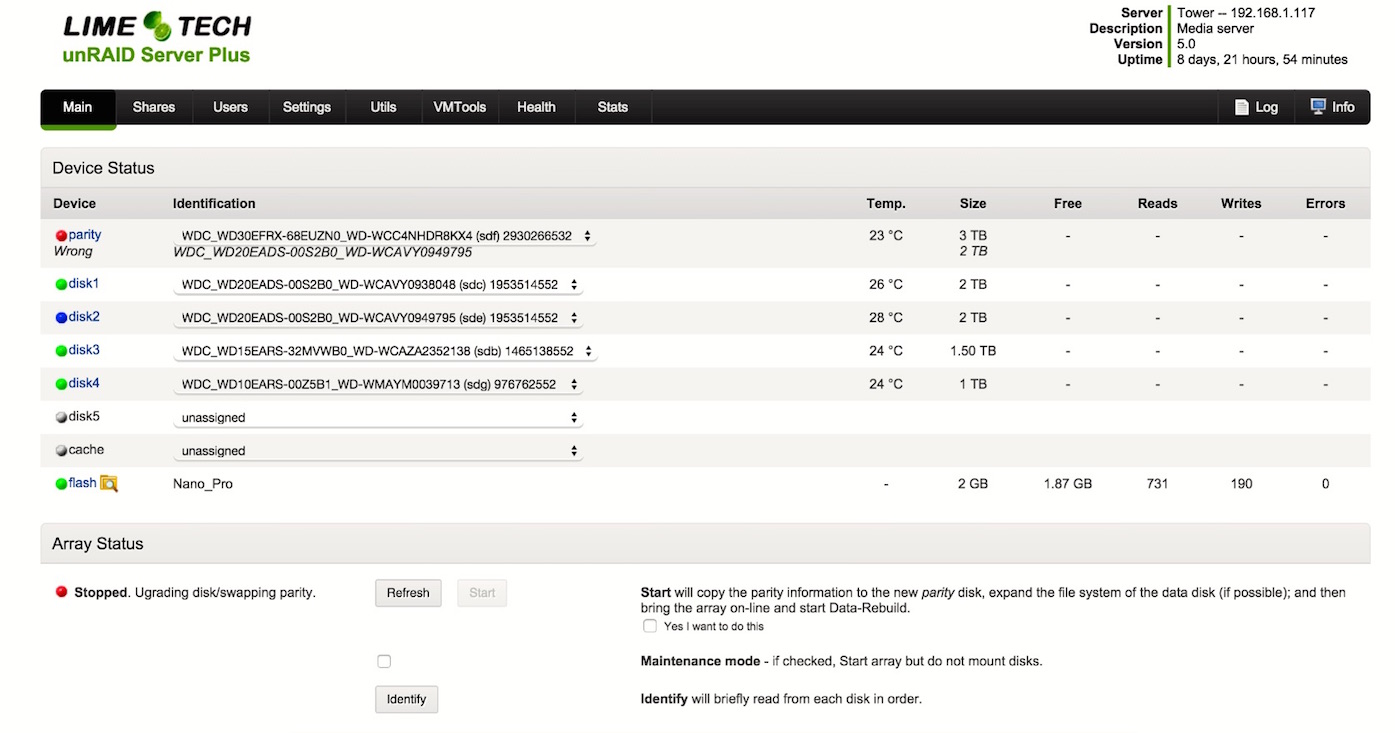

Ok, everything went fine up until the last step! I've attached my current configuration. As you can see, I have the option to check the box then Start the array. However, it does not do anything. I think it is because it says "Wrong" right next to my parity drive. Any ideas?
Thanks!!!
I have no idea why it won't proceed -- it's clearly giving you the option to do so, which is how the Swap-Disable is supposed to work.
If you check the "Yes I want to do this" box, do you then get the option to Start the array?    And if you then click on Start does ANYTHING happen?
Yep, when I check the "Yes..." box the Start button becomes active. When I click it, the page refreshes and nothing changes. I've attached a snippet of the log that contains me clicking the Start button. You can see in there that there is "Jan 14 21:51:19 Tower emhttp: swap_dsbl copy not complete"
log.txt
I simply don't know why it won't proceed.    There have been some previous notes about Swap-Disable not working correctly in the new versions, but others have said it did, so I assumed it was simply a matter of getting the process right.
But you've clearly done that -- as evidenced by the box that SAYS it's going to do it once you check the box.
I'd send Tom a PM to see if he can help get this working for you.
