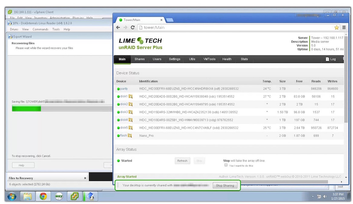

In case anyone is still following this thread, here's an update:
1) I have the array back up and running after doing a New Config and adding in my two new 3TB drives.
2) I bought an external drive dock, plugged it into my Windows 7 VM, and read it using Linux Reader. It is currently copying over the 1.7TB of data from my failing drive. Only 1.4TB to go...
Does anyone know how the errors will be handled during file copy? Will the file be copied over incorrectly or will the copy fail altogether? Or is that not possible to tell??
I think the most likely thing on error is that a particular file will generate an error if it cannot be read.    However there is always a faint chance that the drive will report data has been read correctly when it has not.  This latter case is the classic one (albeit rare) that can lead to 'bit-rot' of data, and if you want to protect against this then you need to have file checksums for each file so you can detect it.
Agree with itimpi -- it's not really possible to tell if you don't have file checksums.  But by far the most likely thing is you'd get a read error reported and the offending file wouldn't copy.    Note that if you're using Windows Explorer to do the copies, this will also abort the entire copy process (not good).    If that happens, use something like SyncBack (or TeraCopy) to start the copy over ... these will continue copying the good files if a single file has an error.
I am using the Export Wizard in the Linux Reader program that you mentioned. That should be fine right?
See attached.
Yes, that should be fine -- and I'm fairly certain it will alert you if there are any errors encountered.
