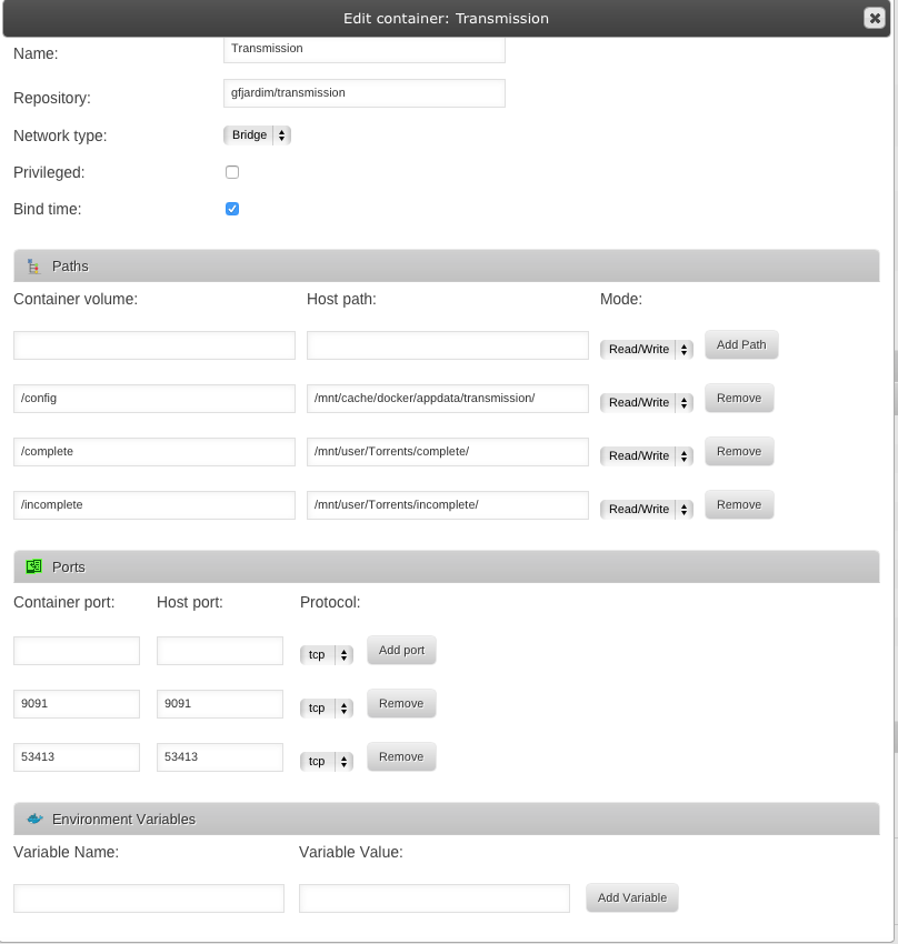

I have mine mapped as such:
Torrents/complete
Torrents/incomplete
I tend to cheat. Set the container up the best you can and then stop the container.  CD to your docker container.  In my case /mnt/cache/docker/appdata/tranmission.  Then "nano" settings.son and edit to your liking (container must be stopped).  I changed the complete and incomplete sections and changed the UMASK to 2. Re-start container and everything you edited sticks for the exception of port. make sure that is taken care of in the initial stage on the -p section.
