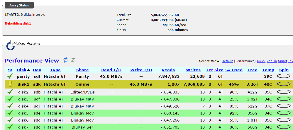

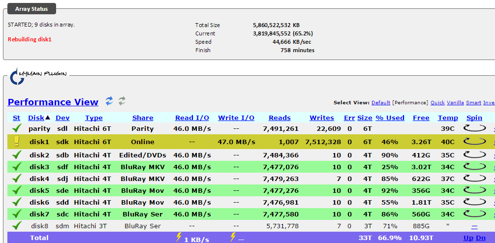

OK.  Looks like the Parity IS read past the point of the size of original drive but no writes should ever be needed on a rebuild except on the drive being rebuilt.  See attached graphic of rebuild of 3TB drive on a 6TB.

I don't think so -- I'm fairly certain the only thing written to the drive after the original size of the drive is exceed is zeroes (with a caveat I'll note in a minute).
Note that the # of writes to the parity drive doesn't change in your 2 graphics -- indicating that although the parity drive is still being read, it is NOT being written.    If there was anything other-than-zeroes being written to the new drive at that point, there would also be writes to the parity drive to ensure parity was up-to-date.
