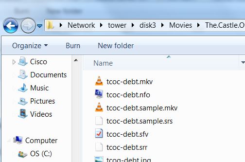

Really? Well crap... I dunno what to do about those files then. I just assumed if I pulled the disk out and hooked it up I could read from it, lol. I wonder if I change over to 6 and then spin it up without that disk in the array if I can still copy it via a browser since they're all captured in parity... even when that disk was totally removed from the machine, it still showed "Disk 3" in a browser and I could copy stuff.

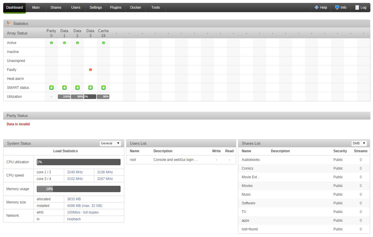

Okay, so this is what I have going on so far... I just went ahead and spun it up on unRAID 6 and prayed nothing crazy happened... I guess it's kind of a mute point now. I got the array running, I just need to back up disk 3 and the preclear it again.
Now I'm having a weird issue where if I don't boot in safemode I can't connect via the web interface, but I think I'm going to lick that one on my own next boot.
So i let it go ahead and try to rebuild. It failed and showed the disk as faulty. Then "preclear_disk.sh -l" showed it as /dev/sdg instead of the /dev/sdf it has been. I restarted and did a "preclear_disk.sh -l", and now that's returning "No un-assigned disks detected"... I am crazy tired. Ugh.

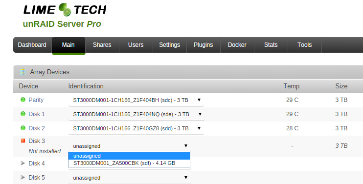

I am super confused... That disk disappeared again. I clicked the drop down box to add it as disk 3, and then it disappeared. The selection read "unassigned". When I clicked it again there wasn't anything there to select. I went ahead and started up the array, and "Disk 3" shows up i the file system browsing from Windows. I assumed this is because the parity has the file info, and I was about to start backing up stuff from there... I looked at the log, and it shows the mover has started, an then a NEW file pops up in Disk 3 that has been moved over from the Cache.
If the drive is not appearing in the drop down when you try to assign it to disk 3 (I assume the array is stopped at the time) then that means it is not being seen at the Linux level.  This is a bit strange if you have just successfully pre-cleared it.  Normally it would appear in the drop down list so that you can assign the drive to disk 3.
At the share level what you see is expected behaviour as Disk 3 is being emulated by the combination of the other drives plus parity if the physical disk is missing.
...  "Disk 3" shows up i the file system browsing from Windows. I assumed this is because the parity has the file info ...
The parity drive has NO file info ... it only contains the a single XOR'd parity bit for each "slice" of data across all of the data disks.  A missing disk (i.e. disk3) is reconstructed by examining the corresponding bits for ALL of the other data disks PLUS the parity disk ... which lets the system computationally determine what bit was on the missing disk at that point.
...  I was about to start backing up stuff from there...

So I was about to post in reply, and add some screenshots and info, and then this happened!! I am about to pull all my hair out.
Here's a SMART report to go with... I have now changed power cable, sata port, sata cable, and this is the third disk I've tried to add.
