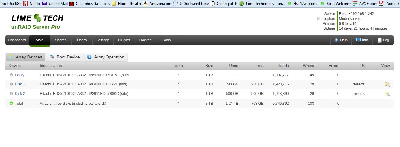

I think you misunderstand how unRAID is meant to work!
Most of the time it is run in headless mode without a monitor/keyboard attached and you manage and configure it using a browser on another system.  You point the browser at http://tower (by default) or the IP address assigned to the unRAID system.
If you DO have a monitor/keyboard attached then you can log in at the Linux level.  However the average user is not expected to do this.  The Linux level would only be used for users happy with the Linux command line and while troubleshooting.  It does NOT provide a way of configuring and managing the system unless you are VERY capable in Linux.
This is what the 'Main' tab of GUI  (Graphical User Interface) looks like in the Firefox browser:
