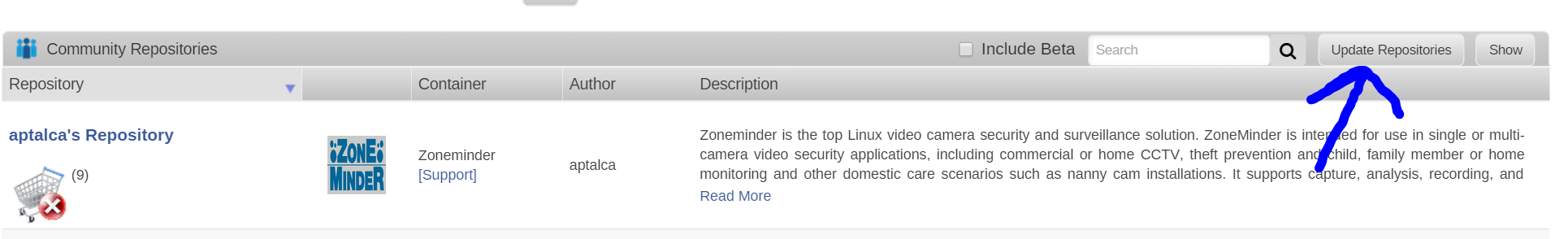

I added your repo 10 mins before posting my original question and forgive me I can't find the update button anywhere you have circled! beta16?
do you have the community repo plugin yet ?
Ahh, so you went with the second option of installing. In that case, you can just hit the save button underneath where you enter the repositories and it should update the ones already saved. After that the new templates should show up.
The picture I posted is for the community repositories plugin. It is pretty awesome as you can browse all the containers available by all the devs, Then you can click on any one of their container logos to add the specific container. The plugin pulls the info from all the repositories. Here's the page for the plugin: http://lime-technology.com/forum/index.php?topic=39106.0
