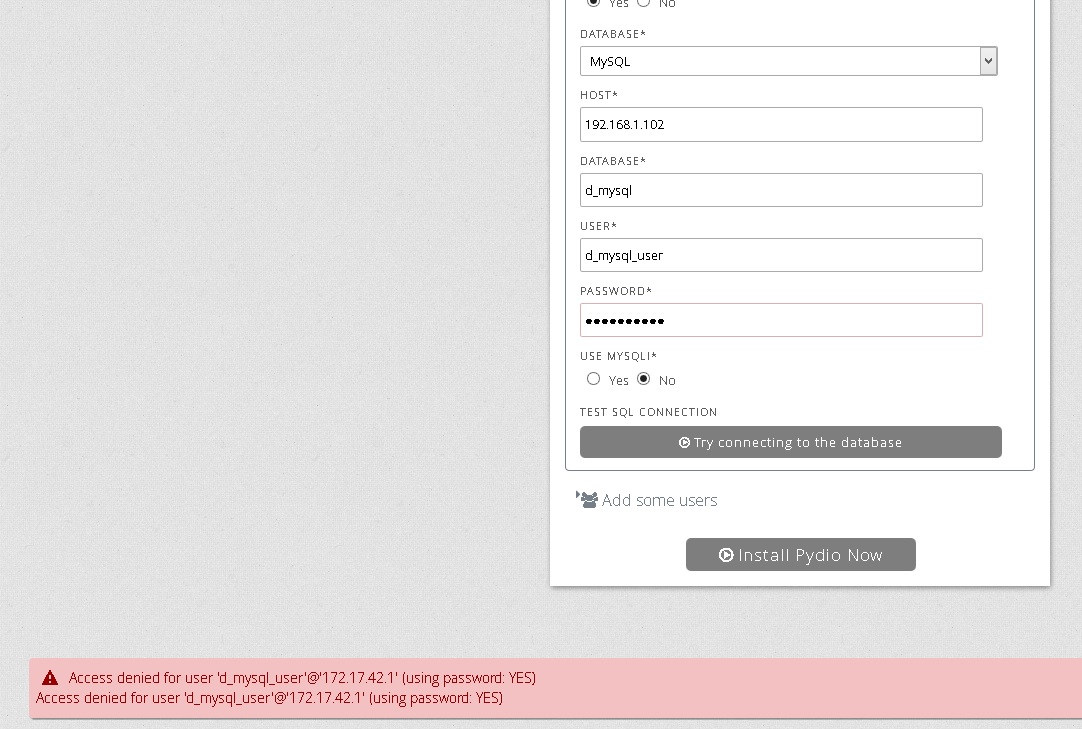

nope, you have to use the unraid server's IP.
localhost to a container is anything within that SPECIFIC container only.
The LAN IP should be ok right? We don't need to port forward and use the WAN IP (or what the Inet sees from the router, correct?)
If so; I'm getting this error. It is strange because I can connect to the DB with the same credentials via my Windows PC with MySQL Workbench.
Not sure where Pydio is getting that IP from though (see attachment):

i don't have any experience with that container, i don't know whether that's an admin account.
i tested the mysql connection with the mariadb container, i created a user called pydio and a database of the same name with full privileges to it.
Type 'help;' or '\h' for help. Type '\c' to clear the current input statement.
MariaDB [(none)]> CREATE USER 'pydio' IDENTIFIED BY 'pydio';
Query OK, 0 rows affected (0.01 sec)
MariaDB [(none)]> create database pydio;
Query OK, 1 row affected (0.00 sec)
MariaDB [(none)]> GRANT ALL ON *.* TO 'pydio';
Query OK, 0 rows affected (0.00 sec)
Ok; I think I know what I did wrong... Thanks for the help!
