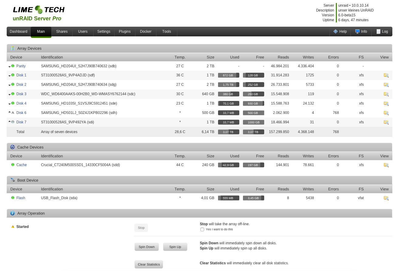

Hello,
I am running an unRAID Pro (6b15) instance with 8 disks (1 Parity, 6 Data, 1 SSD Cache). For a few days, one of the data disks shows a grey arrow in the Dashboard and Main section, and it says "Parity Status: Data is invalid" on the dashboard.
This has happened before and I fixed it for the moment by creating a new config. I also swapped the disk in question with a different one of the same brand (Samsung 501LJ). What does the error message mean, what should I do now, and is there a chance that this may be related to a firmware problem with the 501LJ that can cause problems in RAID(0|1) setups? See here: http://forum.synology.com/enu/viewtopic.php?f=26&t=10020

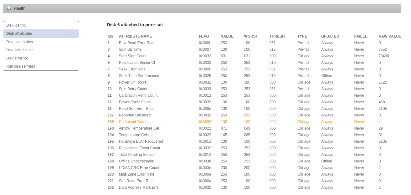

From Main, click on Disk6, then Health - Disk attributes
post screenshot

You have rebooted since that first pic of your Main screen.  Do you happen to have the syslog for that session, with the 768 errors on Disk 6?
Yes, I shut the machine down to check the cables again. Unfortunately, I don't have any other log.
My most important concern right now: in this state, is my array safe if one of the other drives goes? As you can see from the screenshot, there is nothing on the 501LJ, so it wouldn't be a problem to remove it and create a new config without that drive.

The Start Stop Count attribute has unusual numbers, which may indicate a mechanical issue with the drive, but apart from a single Data Address Mark error, there are no sector issues evident.  The long test will be good to verify that.
The firmware update does look like it may be necessary.  The RAID connection appears to me to be a red herring, in that this drive with firmware less than CR100-13 can apparently hang at random times, under certain but unknown conditions.  Yours has firmware CR100-10, which is a problem.  ANY system, RAID or not, will degrade if a drive hangs!  The reputation for this drive is not good, not sure I would trust it in my array, unless firmware upgraded.
All right, I did the procedure that you recommended: smartctl, extended self test, smartctl. I attached both reports, everything passed cleanly. smart.txt is before the test, smart2.txt is after.
