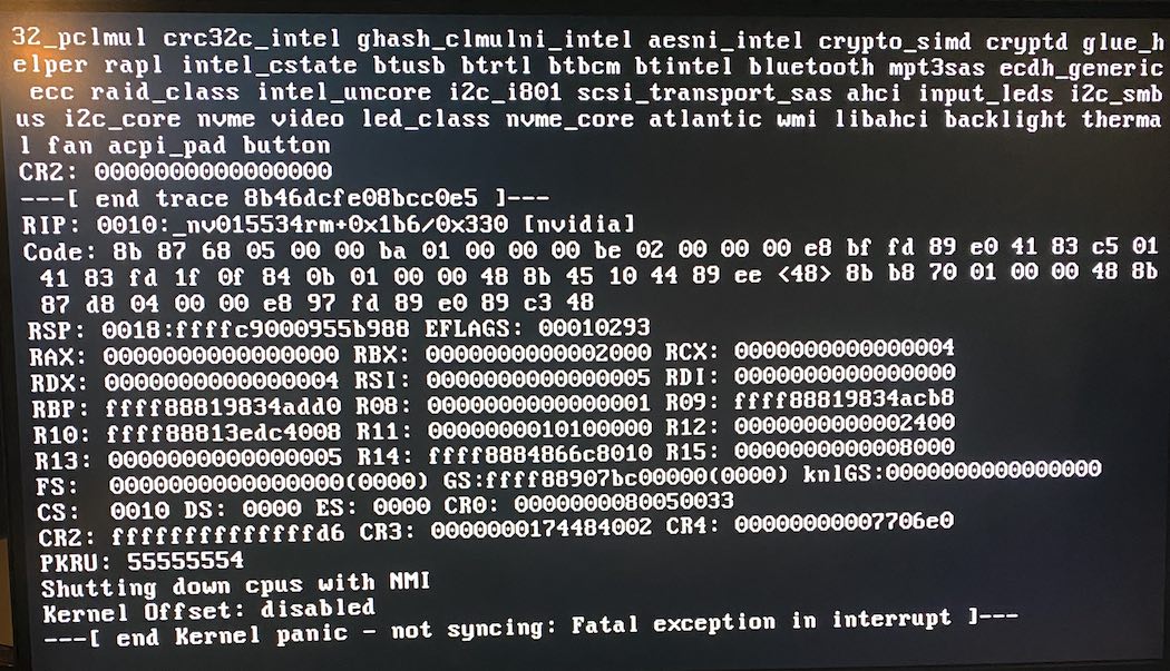

I need the advice what to do with this drive.
Model/ID: ST6000DM003-2CY186_ZR10CJF8. I don't remember when exactly I got it, but should be no older than 2 years, used very moderately.
This was a data drive in a newly created array (4x 6TB, with 1 parity), all attached through the "Serial Attached SCSI controller: Broadcom / LSI SAS2308 PCI-Express Fusion-MPT SAS-2 (rev 05)." (as listed in devices) During the initial parity build it reported a huge number of errors. I assumed it was due to a loose SATA cable, checked/tightened all cables carefully. Upon trying to write to this drive's share, Unraid disabled it. I recreated the array, checked cables again - still the same result, the drive is being disabled after any write attempt. Quick SMART test gives no errors. SMART is attached.
I removed the drive from the array for now. What should I do next? Should I just trash it or what?

Well, I just tried. I created a share which should use the questionable drive exclusively and tried to write a file to it, Right after that i got Unraid crashed - here is a screenshot of the kernel panic. I have no idea what's happening, the unraid setup is quite mint, I had just 2 dockers running at the moment (Heimdall and Cloudflaredydns).
Post diagnostics. We don't know anything about your system except that one SMART report
