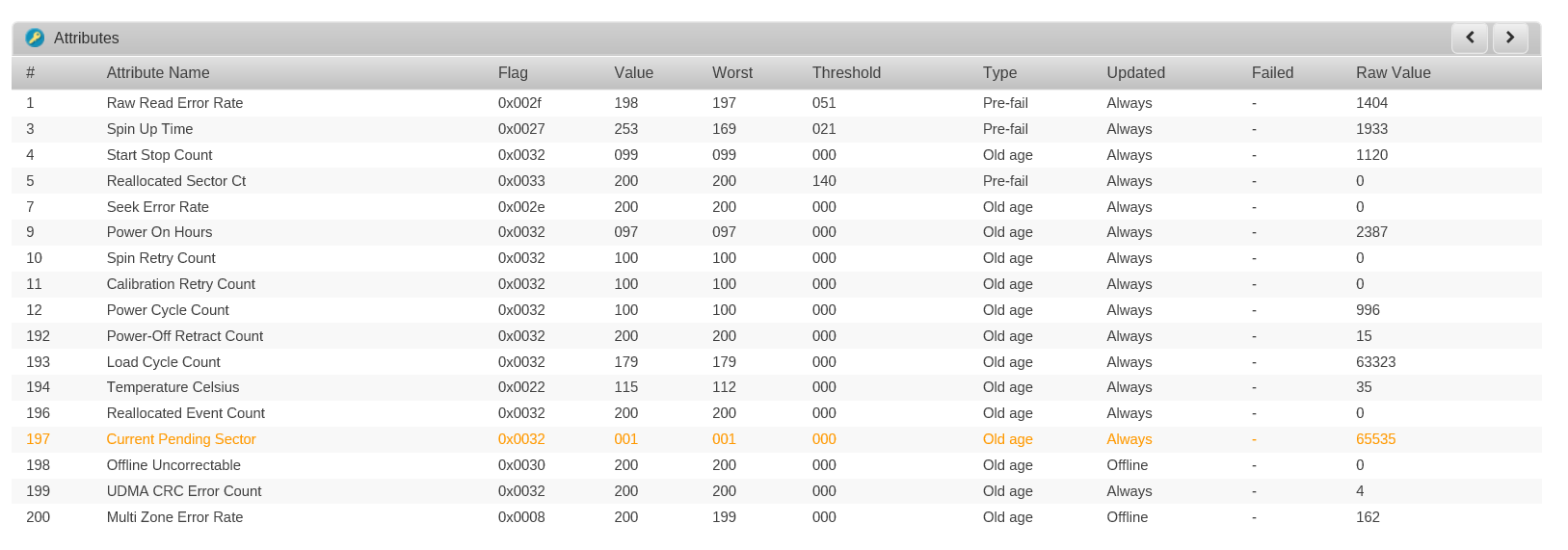

Now I am in the process of rsyncing all my data back on to the server, and playing around with the nice new Unraid 6 UI, I noticed one line in orange: Current Pending Sector (see attached screenshot).  Any ideas if this is actually a problem or if there is anything I should do?

Am I reading this right, there are >65k current pending sectors!?!?!
(see screenshot in post 1)
Interesting.  I suspect that's an erroneous value ... 65535 is -1 in a signed 16-bit register  => and may very well be somehow related to removal of the jumper (although it's not clear how this would happen).

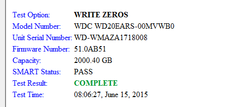

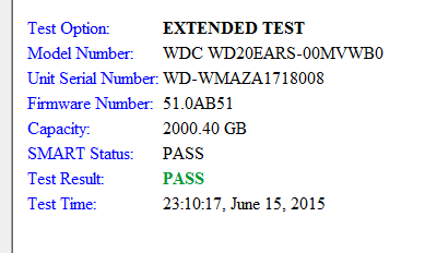

Ok, drive cleared - COMPLETED.  Extended test run - PASSED.
End SMART test still showing 1 current pending sector.

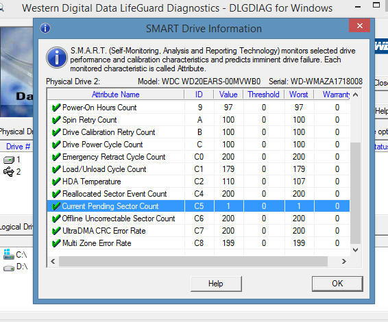

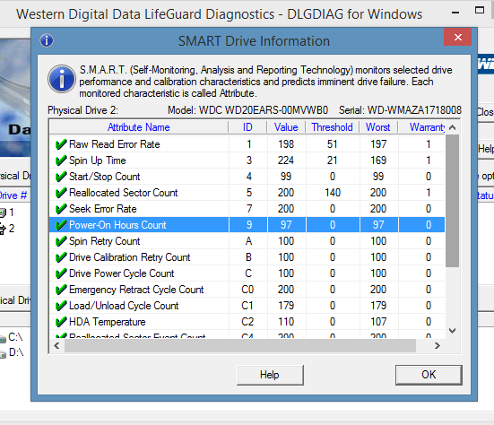

The "Value" column you highlighted is NOT the # of pending sectors.    That column is the value associated with each of the parameters.    Data Lifeguard doesn't show the actual raw values, which is what you want to see now.

I don't know why WD doesn't show the raw values in the SMART display in Data Lifeguard, but for whatever reason they choose not to.    The "Value" column you're looking at is actually a "Normalized Value" that is set differently by different manufacturers.    Typically a "perfect" setting for this is either 100, 200, or 253 => and as it declines it's getting worse.  A value of 1 is very low, but it's still above the threshold value of 0, so it's not a "failing" parameter.  What you need to see is the current raw value, which WAS 65535 earlier.  If that's now cleared all is fine.  Actually, even if it's not, the drive is likely fine ... it's likely a "glitch" in the SMART data ... but I'd still take it out of service in the array, just to be safe [use it as a backup drive].

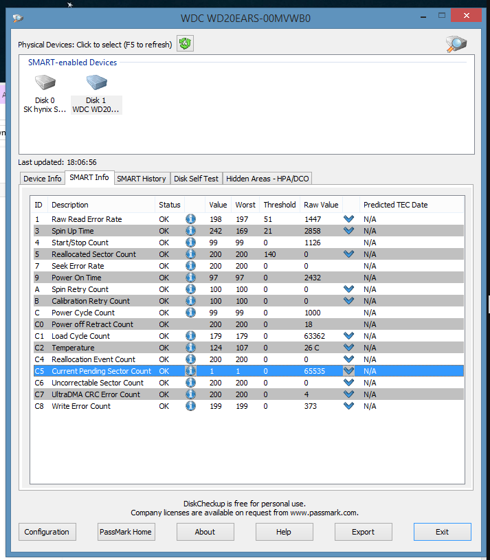

Ok, results from Passmark attached...

Here are the exported values from Disk Checkup:
*** DiskCheckup V3.3 Build: 1000 Report ***
SysInfo DLL Version:                                                  SysInfo v1.0 Build: 1090
Time of export:                                                      18:17:57 16-Jun-2015
Device information:
  Device ID:                                                        1
  Interface:                                                        USB
  Device Capacity:                                                  1907726 MB
  Serial Number:                                                    WD-WMAZA1718008
  Model Number:                                                      WDC WD20EARS-00MVWB0
SMART ATTRIBUTES:
ID Description                        Status    Value    Worst    Threshold Raw Value TEC
  1 Raw Read Error Rate                OK        198      197      51        1447      N.A.
  3 Spin Up Time                        OK        242      169      21        2858      N.A.
  4 Start/Stop Count                    OK        99        99        0        1126      N.A.
  5 Reallocated Sector Count            OK        200      200      140      0        N.A.
  7 Seek Error Rate                    OK        200      200      0        0        N.A.
  9 Power On Time                      OK        97        97        0        2432      N.A.
10 Spin Retry Count                    OK        100      100      0        0        N.A.
11 Calibration Retry Count            OK        100      100      0        0        N.A.
12 Power Cycle Count                  OK        99        99        0        1000      N.A.
192 Power off Retract Count            OK        200      200      0        18        N.A.
193 Load Cycle Count                    OK        179      179      0        63367    N.A.
194 Temperature                        OK        119      107      0        31 C      N.A.
196 Reallocation Event Count            OK        200      200      0        0        N.A.
197 Current Pending Sector Count        OK        1        1        0        65535    N.A.
198 Uncorrectable Sector Count          OK        200      200      0        0        N.A.
199 UltraDMA CRC Error Count            OK        200      200      0        4        N.A.
200 Write Error Count                  OK        199      199      0        373      N.A.
As I'm sure you noticed, the S.M.A.R.T. data still shows the (almost certainly incorrect)  65535 value for pending sectors.
This is either a -0 or a -1  in a signed binary register (depends on whether the drive's firmware uses one's complement or two's complement.  In either case, I don't think it's a valid number ... but not at all sure how (or if) it can be corrected.
The drive is likely fine ... I doubt it'll cause any issues at all; but if you want to be overly cautious I'd just use it as a backup drive and replace it with a drive without that issue.
