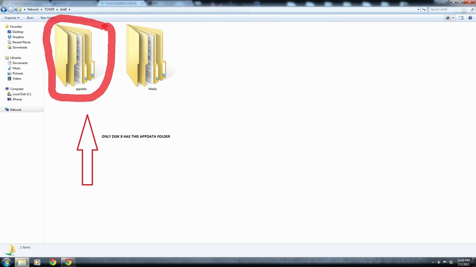

I went ahead and installed Plex via Docker.  Everything works with Plex.  However, I noticed that drive / disk 8 now has two folders.  One fold Media, and the second folder AppData.  Why would disk 8 have Appdata folder, and all of my other disk only have the Media folder, which contains Movies and TV Shows folder?
I looked at the date the appdata folder was created on disk 8, and it shows 7/1/2015.  I thought if any folder would be generated by installing Plex, they would be in the cache drive only?  Shouldn't all drives 1 through 8 have the same folder(s)?

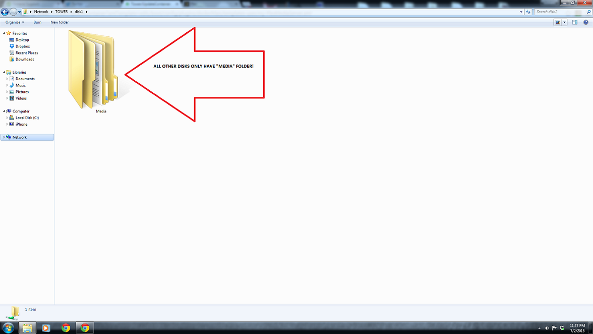

As you can see in this picture disk 1 only has the Media folder!

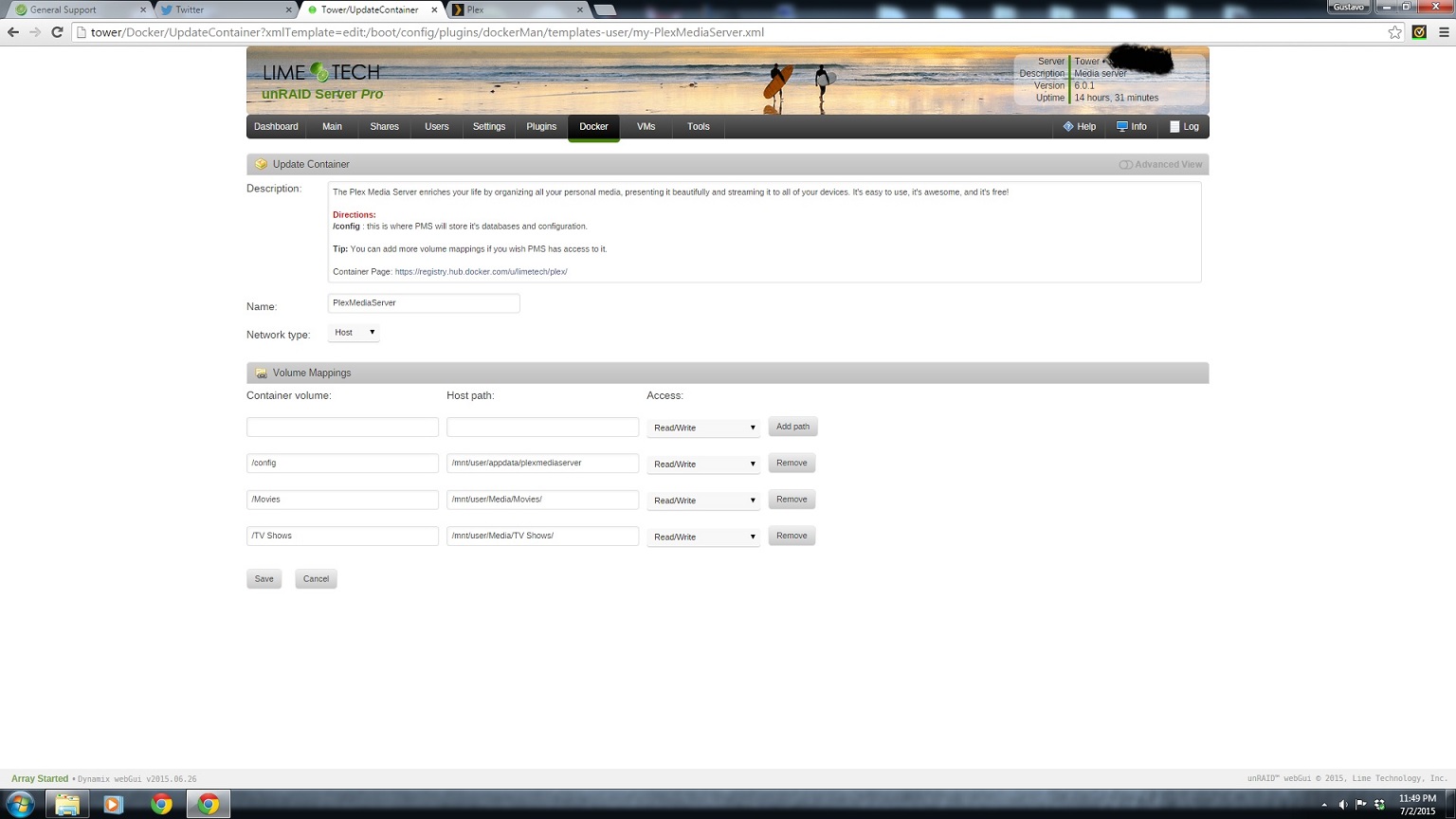

Here's the setting of my Plex application:
Did you already have an appdata share set to cache-only? If not, then you haven't actually told unRAID to put the appdata share on cache and it just put it wherever. It might have initially wrote it to cache but then mover moved it to the array.

I followed the instructions from another post in the Plex Forum. On my last picture, you can see where I told Plex where the movies and tv shows were.
