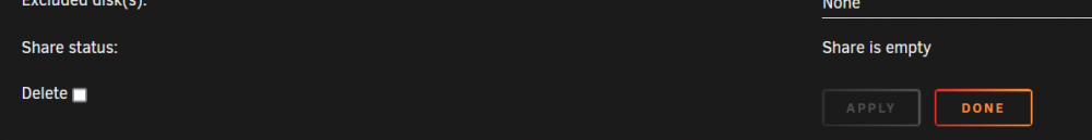

August 2, 201511 yr When the share is empty there is a Delete checkbox next to the 'Apply' button on the share's edit page. When you check this box the Apply button label changes to Delete. To empty the share, navigate to it under Windows Network (or OS X Finder) and delete all the files/directories. There is a bug in 6.0.0/6.0.1 where certain files may not show up via network access. These are files which, on the server side, start with a dot (this is how files are "hidden" in *nix O.S.'s). Normally you never have these kinds of files, but depending on which Apps (ie, docker containers) might access your shares it's possible some of this junk is left behind and the share will not appear "empty".

July 20, 20224 yr 52 minutes ago, Ruckus42 said: Is there a GUI control for this yet? I don't see it Only when the share is empty. Then you have a tick box and can remove a share.
