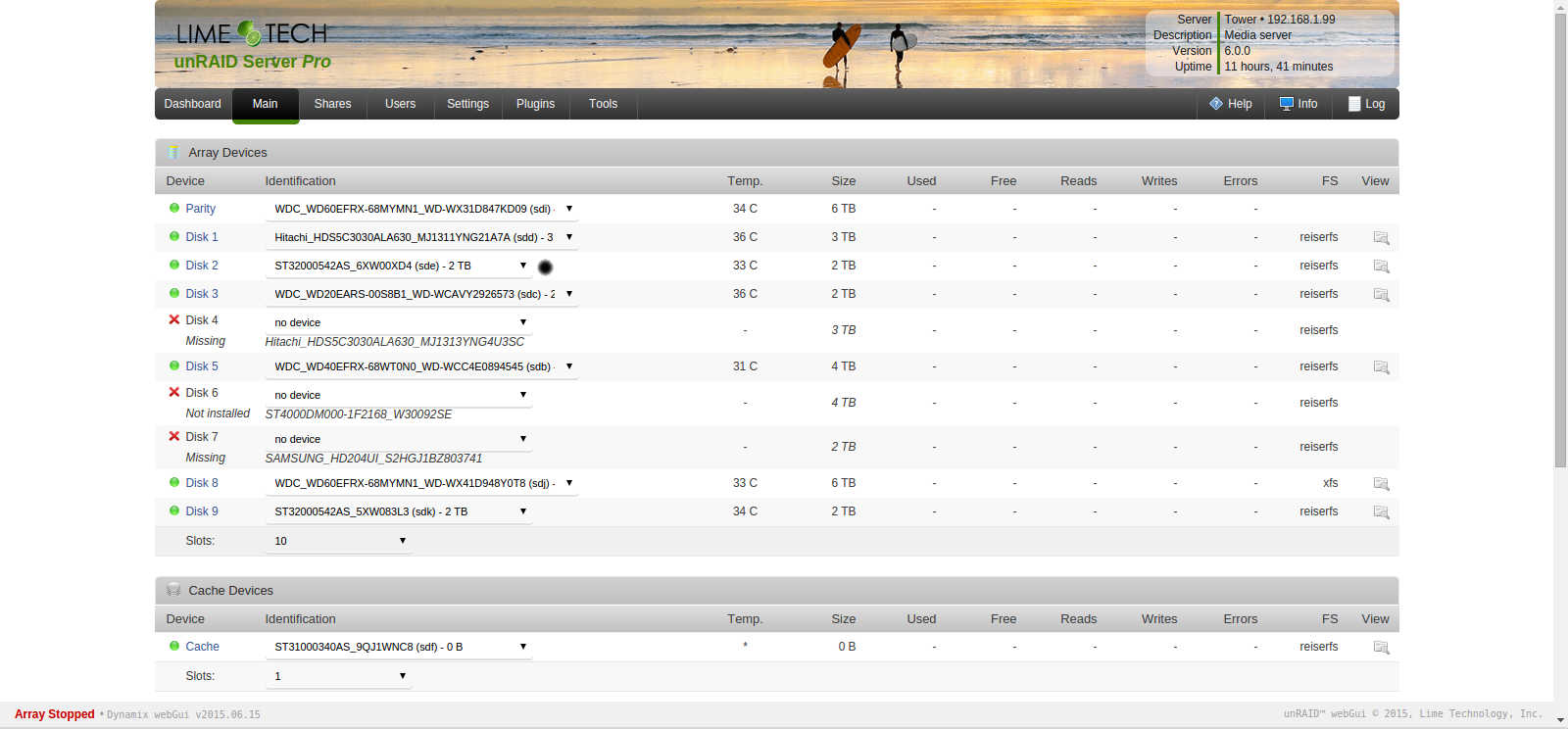

I am having trouble getting the unraid box to boot up. I have a 12 disk system and it wont boot. I removed all the drives and it was able to boot up. I also have tried combinations of different drives plugged in just to see if it boots. Here is partial output from dmesg with 4/12 drives plugged in, any ideas?

So I was able to boot up unraid with all the drives installed. I cannot get to the web interface  and none of the drives are mounted. I was able to ssh in to unraid though. I have attached the diagnostics output. If someone could look at it and let me know what they think that would be great.
tower-diagnostics-20150815-1117.zip
Check your connections. Did you try to access the web interface by IP address?
I ssh in using the ip address (192.168.1.99).... I did a cursory check of the connections (did you mean SATA?).. This looks like a bigger problem  (power supply or motherboard maybe) I tried to connect to the web server using (192.168.1.99), which is what I normally do anyway.
Is this some kind of SATA communication error? If so, I am getting errors on multiple drives. So, unless multiple drives had connections errors magically overnight it must be something else right?

OK, good news, after reviewing the log file in detail I was able to determine the error is limited to 3 drives (namelely ata5, ata7, ata8)  . Also, the webgui finally came up after a long time.. (attached)..it turns out that all the drives that are reporting as "missing" are on the same PCI SATA controller.
So...I am thinking this is a problem with the SATA card (or connection?) correct?

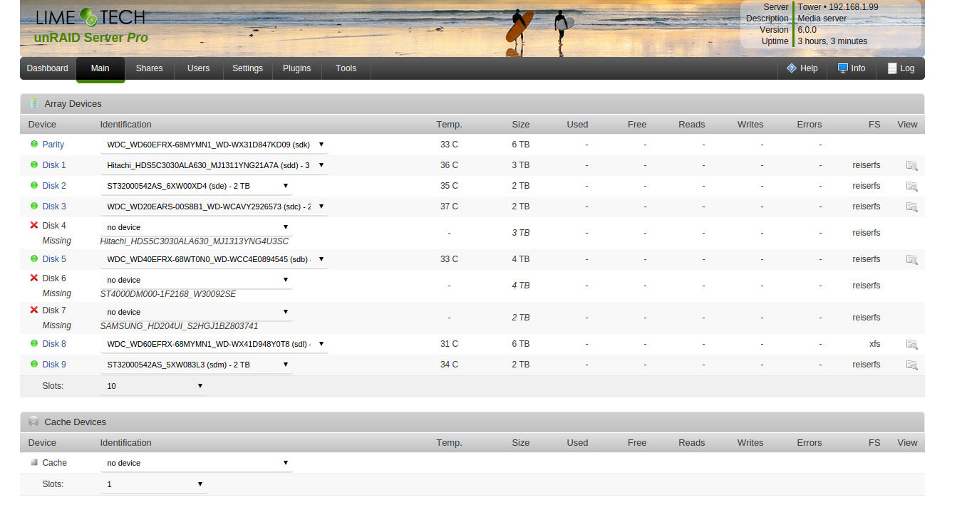

Sorry for the long delay..i did reseat the card and it worked one time...but subsequent boot ups are not effective.. The array is showing several missing disks all tied to the same PCI card. (see attached).... Can someone recommend a replacement card that will work...I have attached a pic of the "bad card" Assuming the card is bad. Here is a link to the current card on amazon.
http://www.amazon.com/gp/product/B0009U6140?psc=1&redirect=true&ref_=oh_aui_detailpage_o00_s00
UPDATE: I thought I would try and switch the SATA Cards to different PCI slots just to see what happened and even after the switch the same PCI card is having issues.  Its looking like that card needs replacement. I have included the link for the one installed but I am open to a different brand if anyone has a suggestion.

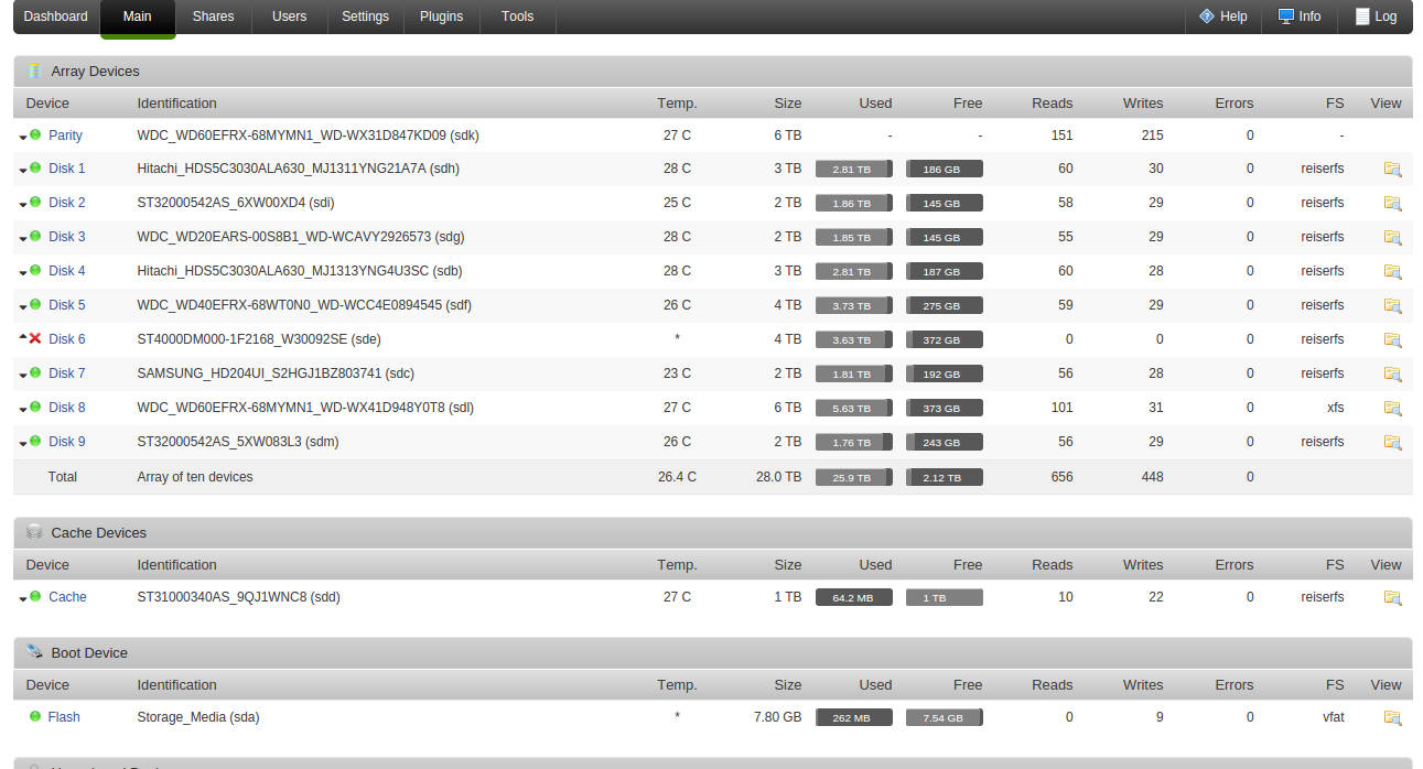

OK, I replace the card and the array is good except for one drive has a red x (screenshot attached)...I tried a search of the forums but couldnt find any help...what does that mean?
