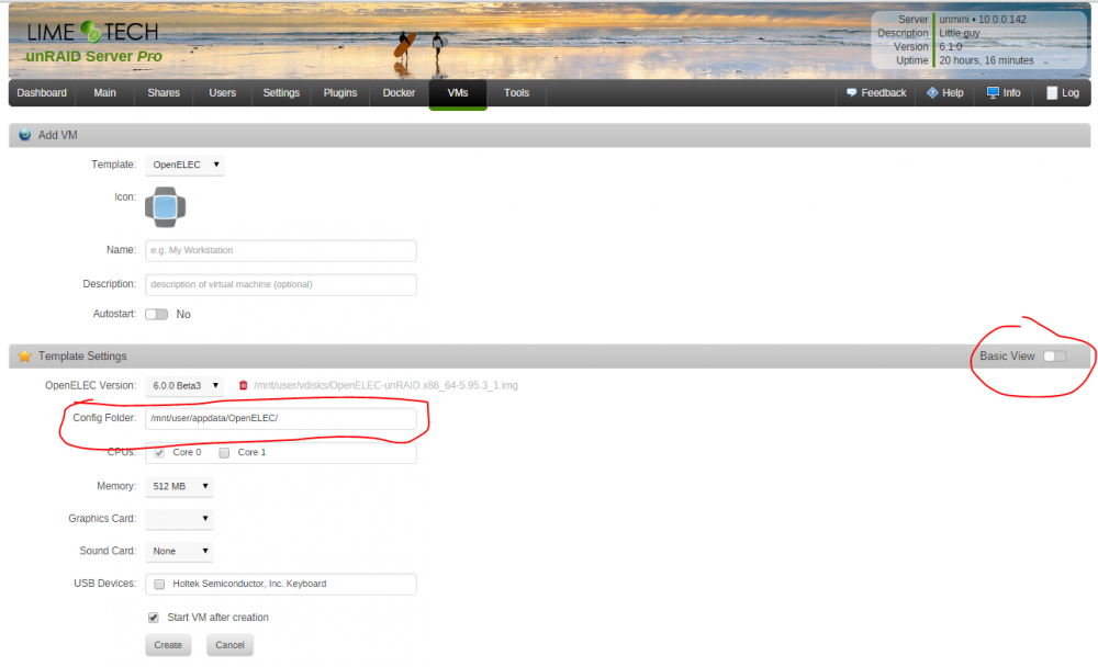

Got another question,
Trying to change the theme tonight, but noticing that this does not seem to work.  Doing some reading, and it seems that this VM template was created as read only.  Is there a way to make it writeable so that I can change the default theme?
Thanks
Thanks
No, but it should work because we store all that data (including any skins) in the appdata folder.  What skin were you trying to load?  Keep in mind that some skins may not yet be compatible with this version of Kodi (has nothing to do with our VM).  Try Aeon Nox.  I know that one works.

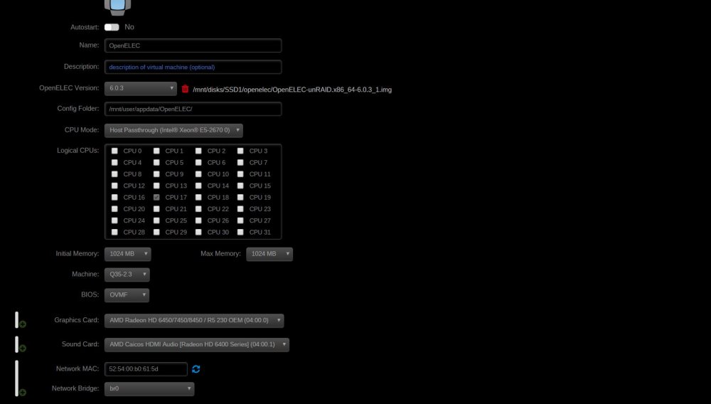

Hey Jonp,
I've got an issue similar to SuperW2 on the first page, only it doesn't seem to be an IOMMU group conflict, but a permission issue. Take a look:
Just for reference, here's my IOMMU Group list:

I tried relocating the GPU to other PCIe slots, as well as enabling ACS Override, to no avail.
The GPU is an Nvidia GT30. Motherboard is an Asus DSEB-DG/SAS. My next step is to review the BIOS settings, but I'm hoping you can chime in with something.

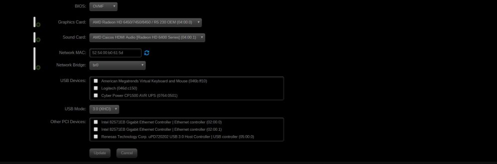

I'm still scratching my head with the issues mentioned below. I tested some USB passthrough devices on another VM to ensure vt-d is working, and it looks like it is. I am guessing that maybe the syslinux.cfg changes didn't provide the right solution. Any ideas?
edit: Nevermind, based on my discussions in this post, http://lime-technology.com/forum/index.php?topic=42770.msg407518#msg407518, I'm assuming that my issues are hardware related.
Just an FYI, USB device assignment is not the same as PCI pass through. USB devices should be assignable, even without VT-d.
Looks like it's a video card compatibility issue. the EVGA GT 730 I was trying to use wouldn't get passed through into any VM, but when i swapped it for an AMD Radeon 5000 series it works just fine.
Chances are if you put the radeon in your primary graphics slot and the nvidia in the secondary, you could pass through the nvidia card.
